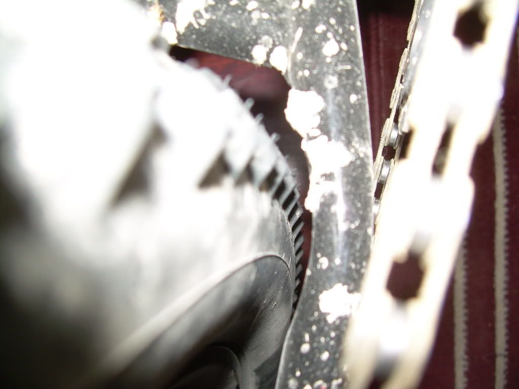

    Here's a 2.4 Racing Ralph on a 35mm wide Salsa Gordo. Clearance is about 5mm, maybe a little less. It's rubbed a few times, but only very tip of the knob buzz as far as I can tell.
    The Ralph may be the tallest tire to fit in this frame as at the seatstay brace/bridge there is only about 3-4 mm clearance with the small knobs on Ralph. I'm thinking a big knob true 2.4 on the rear of this frame would be too much.

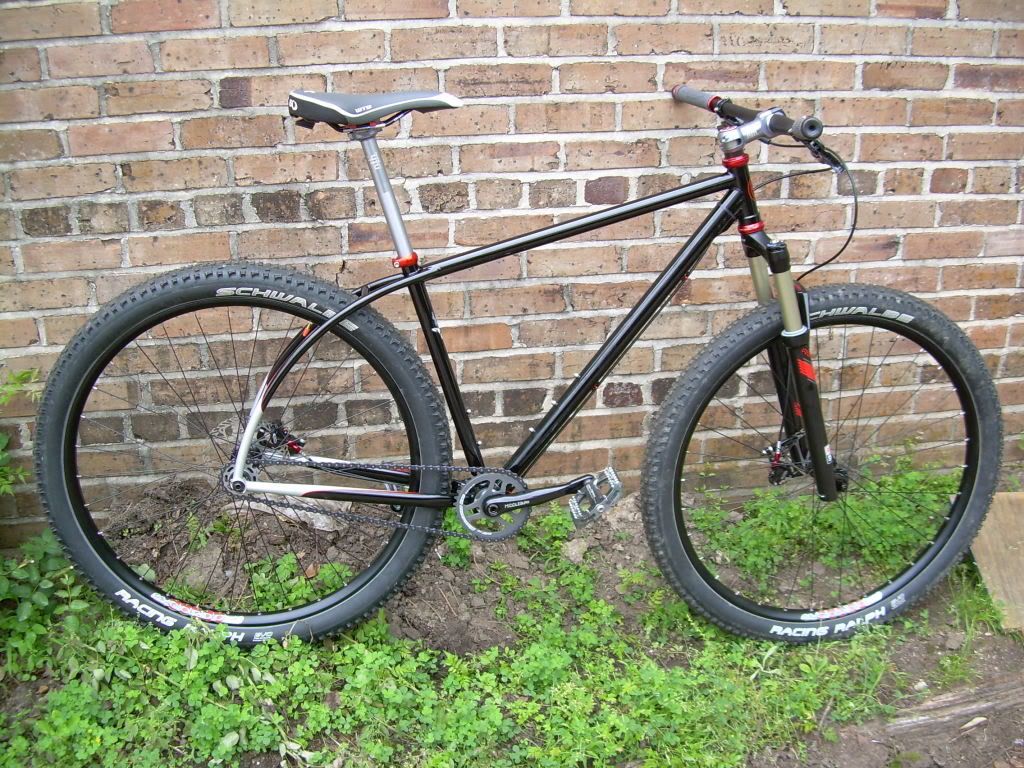

    Salsa El Mariachi. Here's Racing Ralph 2.4's on Speedway 50mm Uma's...about 64mm wide tire with comfortable clearance:
