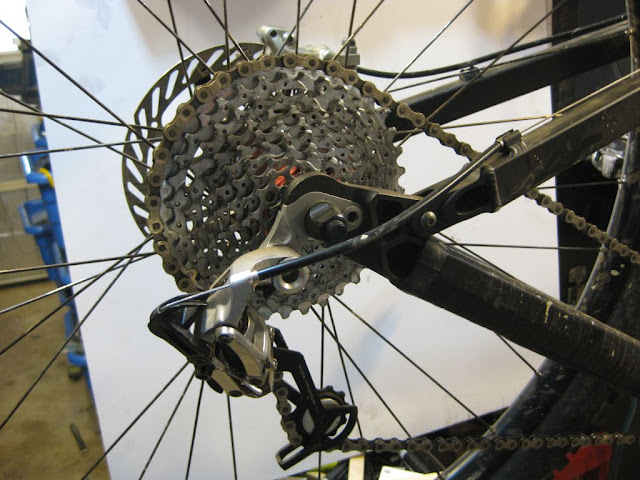

    Currently, I am running a 11-37 Sram (soon to be 11-38) Cass. with a 27t in front (1 X 9) in central TX.(steep, chunky but short) but when I travel out West, I will add a 20t to the crank, and use the 20, 34 combo a lot in a 4 to 6hr ride.
    Are you still with me

    Quote Originally Posted by BRUZED
    Have you any pics of that set-up?
  8. #208
    Reputation: BRUZED's Avatar
    Mar 2006
    152
    Quote Originally Posted by bonesetter2004
    The pictures I have turned out fuzzy. I will take some more and post them in a few days.
