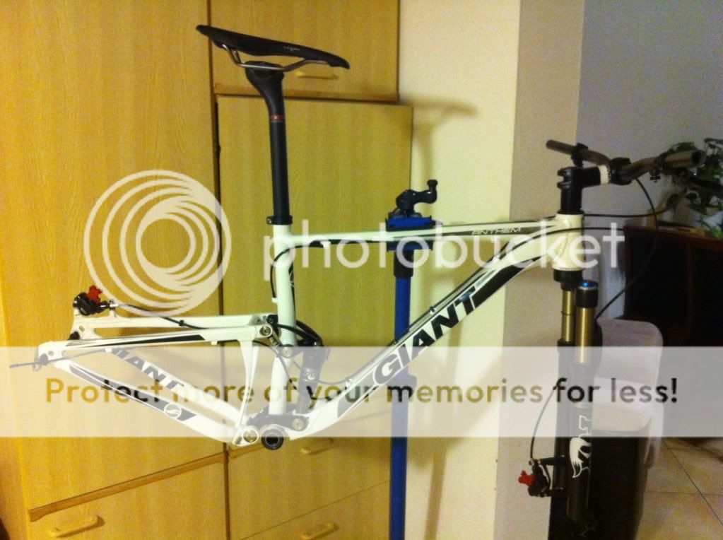

    Nice Anthem X29 in white! This is how my black version looks now (not completely finished yet):

    looks good rapsac... what did the build weight come to?
    Reputation: rapsac's Avatar
    Sep 2004
    495
    It weighs approx 11.2 kg on a hanging scale.
