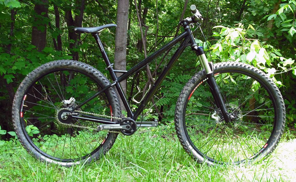

    My Lynskey Ti 29er AM Hardtail, with pics
    I am so excited! The build is "complete"!
    The folks at Lynskey were phenomenal to deal with in all regards :thumbsup: Truly, they were masterful at putting up with my 24/7 OCD which anybody that has had to deal with me can attest is a geniune challenge.
    I insisted the guys at Lynskey ride the bike and put it through the paces on their turf so I am sure they will be able to provide thoughts on the ride shortly which either they or I can post up. I will of course do the same on the West side once I get it but a balanced review across terrain made a lot of sense to me. Hopefully I will have the bike before Christmas :thumbsup:
    The chaps at Lynskey were kind enough to send me this link to the debut of the bike and its particularly cool if you are at all considering the Hammerschmidt as it provides some very good insight and pics characterizing what its all about.
    I will provide detailed pics of course once I get and have no doubt it will meet my expectations.
    The parts for those interested are as follows. I do not have a weight of the frame and/or bike but will check with Lynskey in case anybody is interested.
    FRAME --> Mill Finish 29er “AM” Frame w/ tapered headtube, Helix downtube
    CRANKSET --> SRAM Hammerschmidt 175mm
    HEADSET --> Chris King black 1.125 combo 1.5 headset
    FORK --> Tapered 120mm Reba 29er w/ 20mm maxle
    FRONT SHIFTER --> SRAM X9 Hammerschmidt shifter
    FRONT TIRE --> Maxxis 29er Ardent 2.4
    REAR TIRE --> Maxxis 29er Ardent 2.4
    CASSETTE --> Jeff Jones modified XT 6-speed cassette to fit on King SS rear hub
    BRAKES --> Formula “The One” brakes, w/ adapters and 180mm rotors
    PEDALS --> XTR
    SHIFTER HOUSING --> Jagwire Switch Titanium colored cable and housing
    GRIPS --> Deity lock ons w/ white locks
    WHEELS --> Chris King Pewter hubs laced to Flow 29ers. Front hub 20mm, rear SS hub. Dt comp spokes
    REAR SHIFTER POD --> Shimano XTR shifter
    BARS --> Chromag OS 730mm black low riser bars
    STEM --> Chromag 70mm black Ranger stem
    SADDLE --> Chromag Lynx (black/white) Ti rail saddle
    SEATPOST CLAMP --> Chromag Pewter seatpost collar , 35mm
    SEATPOST --> Chromag Minimalist 400mm length x 30mm
    CHAIN --> SRAM PC991
    REAR DER --> Shimano XTR non-shadow M971
    Literally the ONLY things I will be doing to the bike once received, based entirely on aesthetic reasons of course, are to replace the horrible stock REBA stickers and replace the non-matching :p black Formula brake housing with steel braided HEL performance lines to match the shifter housing on there now.
    Thanks again to Lynskey to the folks at Lynskey and thanks to Larry Mettler for the killer parts as well :thumbsup:
    edit: package included on Lynskey website here

    And for completeness, here is more detailed frame info I posted recently, with my chosen design parameters as follows (and pictured):
    --> Head angle (static w/ 120mm REBA) = 68.5 deg
    --> BB size = 73mm
    --> chainstay length = 17.1"
    --> top tube length = 24.5"
    --> seat tube angle = 72 deg
    --> bottom bracket drop = 50mm
    --> seat tube = 19"
    --> tapered headtube
    pics of drawing can be found here

    FoShizzle
    5 Attachment(s)
    Some more pics of the HS (complete stills TBD as bike is en route to me now...these are all I have)
    Also, in the spirit of doing my part as a Lynskey e-shill, note that Lynskey now has the HS option available to all Lynskey owners as a retro or w/ new frame based on the work done here.
    Some pics accordingly from Lynskey...Please note that for optimal e-riding, as soon as I get bike next week, the black brake hoses will be replaced as will the fugly stock REBA stickers :)

    CRAZY FRED
    Too Funny.
    First of all those are some killer looking photo's, but as I was looking at the fork pictures I had JUST said to myself "WTF Fo, loose the Ghay red Reba stickers will ya...:madman:

    28.93 lbs, w/ tubes and in geared mode so very very happy with that
  • 12-24-2009
    FoShizzle
    More importantly, will be riding Saturday. All that remains is to put on new brake hoses and put on 22t hammerschmidt chainring instead of current one...no rush though
    crude measurement no doubt...but sure seems the 68.5 HA is dialed
    Happy with weight...figure SS will shed a bit over a pound...whatever
    Chromag e-shilling...bar and stem chromag too - recommended IMHO
    HS closeups
    random front wheel/fork shots
    Cawkpit shots
    T/DT shot
    Rear wheel area
    Completes
