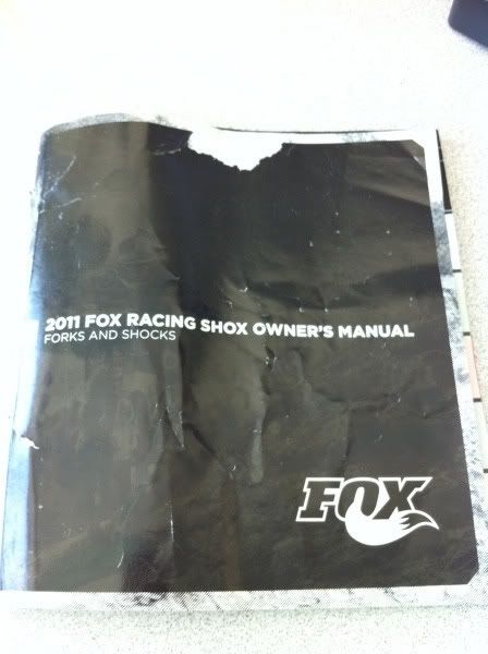

    Wow sure enough! Thanks cany. That's far more informative than what I was given.
    Here's what I was reading, thinking it was "the manual". Wonder where I got that idear :P
    It pretty much only covers install.
