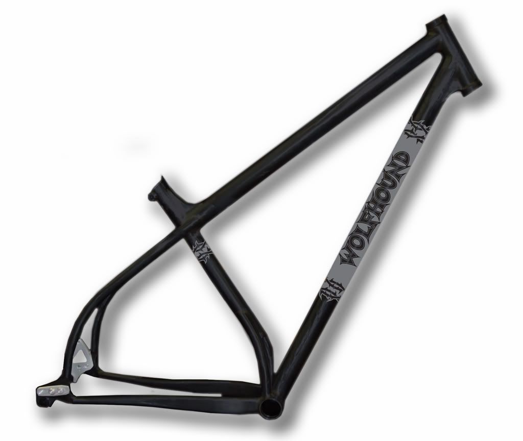

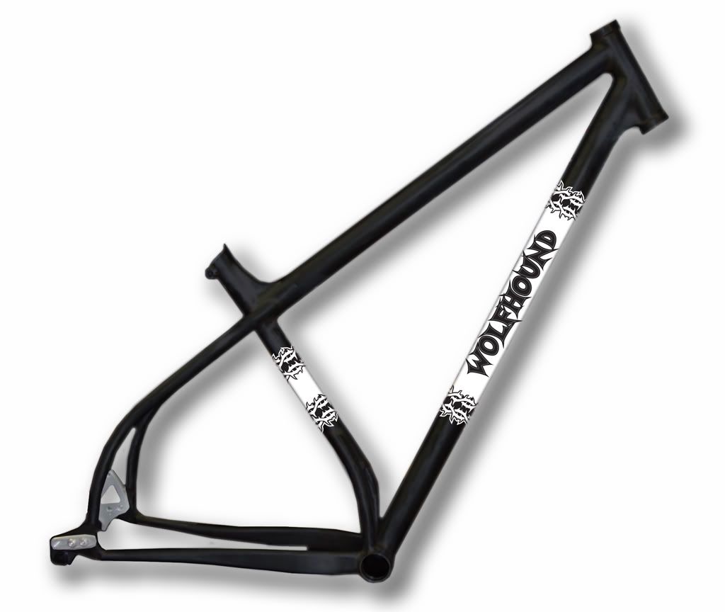

    ...well, after messing with a couple different "mock-ups" for paint...I think I am down to this design. Any thoughts?

    sean350
    [QUOTE=jncarpenter]...well, after messing with a couple different "mock-ups" for paint...I think I am down to this design. Any thoughts?
    Looks nice, but I'm a fan of panels... I think a nice silver colored panel underneath the wolfhound name would look pretty sweet.

    jncarpenter
    Q about the integrated bb. Is it designed like the new Madone bb's where you can basically exchange bearings to go with whatever integrated crankset you are using, or is it crank specific?
    Thanks.
    -Sean
    ...first off, I went through the panels stage before deciding against it:

  • 07-23-2007
    Turt99
    I'm a fan of the panel version you posted, but I'm not a huge fan of the black. The bike looks really freaky and personally I'd go with a bright color so that the little things stand out more. Black tend to hide the curves.
  • 07-23-2007
    jncarpenter
    ...well, I am pretty much an anti-bling type of guy. I really do not like a flashy finish and in fact this bike is as close to flashy as I have gotten in quite some time. I prefer stealthy, downplayed finishes...I'm not trying to stand out:)
    I have to admit, the panels have grown on me :D

  • 07-24-2007
    1 Speed
    Really nice!
  • 07-24-2007
    jncarpenter
    ...having a major last minute mental paralysis with regard to finish :D
    The panels have now won over......I think ;)
  • 07-24-2007
    mud'n'sweat
    Now THAT I like Jay! Mark me down for the panels. :thumbsup:
  • 07-24-2007
    SSINGA
    Panels need to be silver - beyotch!
  • 07-24-2007

  • 07-24-2007
    dRjOn
    lose the pam anderson barb wire bits?
  • 07-24-2007
    RockStarRacing
    panels need to be DITCHED. black with white decals. nuff said.
  • 07-24-2007
    jncarpenter
    ...it is actually thorns & has sentimental meaning to me. :)
  • 07-24-2007
    MMcG
    The black with white panel definitely "pops" out at you a lot more. Wasn't sure if you were going for that effect or the "stealth" effect though.
  • 07-24-2007
    jncarpenter
    ...honestly, the white is just being used for contrast to review the art. I will likely choose a different color (stealthy). I am waiting to hear back from Keith with his personal thoughts toward color selection.
    I am currently using this thread as well as fixating on the art to distract myself during the wait :D
  • 07-24-2007
    El Caballo
    Panels should be dark gray on black.
  • 07-24-2007
    jncarpenter
    ...likely will be :)
