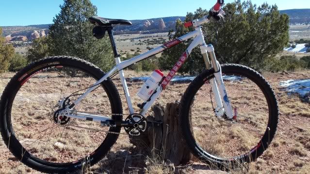

  • 05-17-2010
    urbiksux
    18 inch Voodoo Soukri. Left the fork at 80mm, and it feels really good so far. And yep, steel is smooth! Big thanks to Voodoo for putting this pic on their blog.

    Bugeye
    Soukri 21" in the house!
    A few weeks ago, I rec'd my 21" from BTI. Gotta say, this frame is beautiful. The metallic pearl white is unreal.
    It's a dead-ringer, geometry-wise, for my old Dambala (R.I.P.). I know the Soukri's description calls for a 490mm + fork, but I had a sweet set up on the Dambala with my 470mm Surly fork, so I rigged it up as such, only this time went 1X9 instead of 2X9. Only marked difference I could tell is the 21" model's headtube is about 1/4" longer than that of my Dambala, and it has a beefy gusset on the down tube, and another at the top tube/seat tube junction. The Soukri handles great with the 470, so for those worried about having to run longer length forks, don't sweat it. This bike rocks, and kudos to BTI for staying on top of my order (I requested it in late 09) and to Voodoo for keeping the legacy of the Dambala alive!!

    Thought I'd update... thanks for the advice here, I finished up my Soukri recently, fits like a glove! Rides nice too.
    I just posted a pic in the "post your ss" thread :-)
    http://forums.mtbr.com/8926873-post21.html
    Edit to include initial thoughts:
    I finished the budget minded build a few weeks ago, and will replace/upgrade parts when they break. Due to wet weather, I only have two rides on it so far for a total of about 30 miles on nice but mellow singletrack.
    I built it rigid with the Zombie 500 (500 mm a-c) fork. Fit and finish on the frame is good; paint looks good, and I had no need to face or chase anything. That said, I am using a square taper bb (found a NOS Shimano un72 bb) so the bb shell doesn't have to be perfectly square, like if I were running external bearings.
    I was a bit worried about the high listed standover height, but I size my bikes according to ETT length and stack/reach measurements. At 5'7" with a 31.5" cycling inseam, I went with the 17" frame and am glad to report that I made the correct choice, as the short TT on the 16" would have been too cramped.
    Handling is very quick and precise, as I expected with a 72 degree head angle. The chainstay length feels very good to me; I have it set only a few mm from full forward with 32x20 gearing. I was tempted to get a slack, short stay frame for this build, but am glad I didn't. My 26" hardtail is slack with long-ish travel, so the two bikes compliment each other nicely.
    The only problem I encountered is with the high front end due to the tall 500mm a-c fork. After setting my saddle position (I go old-school KOPS) I had to use a -17 degree stem and flat bar to get my hands low enough (for xc I run the top of my bars even with the top of my saddle, measured with a level). This setup fits me perfectly, but makes me wonder if the tall front end would make fitment difficult for anyone shorter than me?
    Anyway, this is not a real in-depth review, just my initial thoughts with the limited mileage I've put on it so far.
    Sent using Tapatalk

  • 01-24-2012
    edouble
    Nice ride jten9
    I like!. Hows the ride of the Voodoo fork?. I love a nimble bike in the woods which is where the majority of my riding takes place. For my riding slack is wack!, lol. Here is my Soukri.
  • 01-24-2012
    jten9
    That's a great pic! The bike ain't shabby either ;-)
    The fork is actually pretty nice, definitely more compliant than the Surly fork I had on another bike. I think the compliance is due to the long length, because it is really beefy (weighs 3lbs 7oz with uncut steerer!!). My first impression bouncing around a parking lot, was that it was going to be too noodly, but on the trail it feels good... and there's no stutter or vibration under hard braking forces. I was planning on looking for something lighter, but the ride is nice enough I decided to keep it.
    As a bonus, there are pics on the Voodoo blog of a Larry (fat tire) mounted on an Alex dm24 rim, which all fits in the Zombie 500. I hope to try that sooner than later :-)
    Sent using Tapatalk
