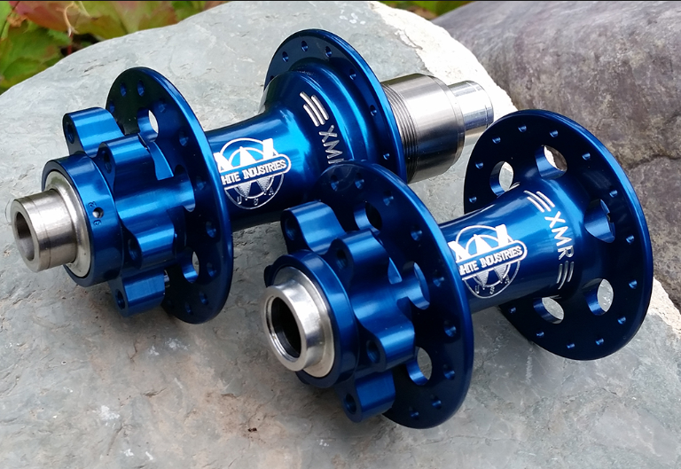

    The white industries XMR's in blue should complement the overall chrome/blue color scheme quite well!
    Those are being paired with the polished Crest Mk3 rims, sapim CX ray's and blue sapim nipples. I really don't like aluminum nipples but make an exception in this case. The blue will look great against the polished steel/aluminum. I will never forget buying a used scott scale LTD with top-shelf DT-Swiss carbon rims and wanting to true them. The aluminum nipples just disintegrated upon attempting to turn. I had to rebuild the wheels to true them. I really hope that will not be the case for me here. If you guys think otherwise, let me know and I will stick with brass nipples!

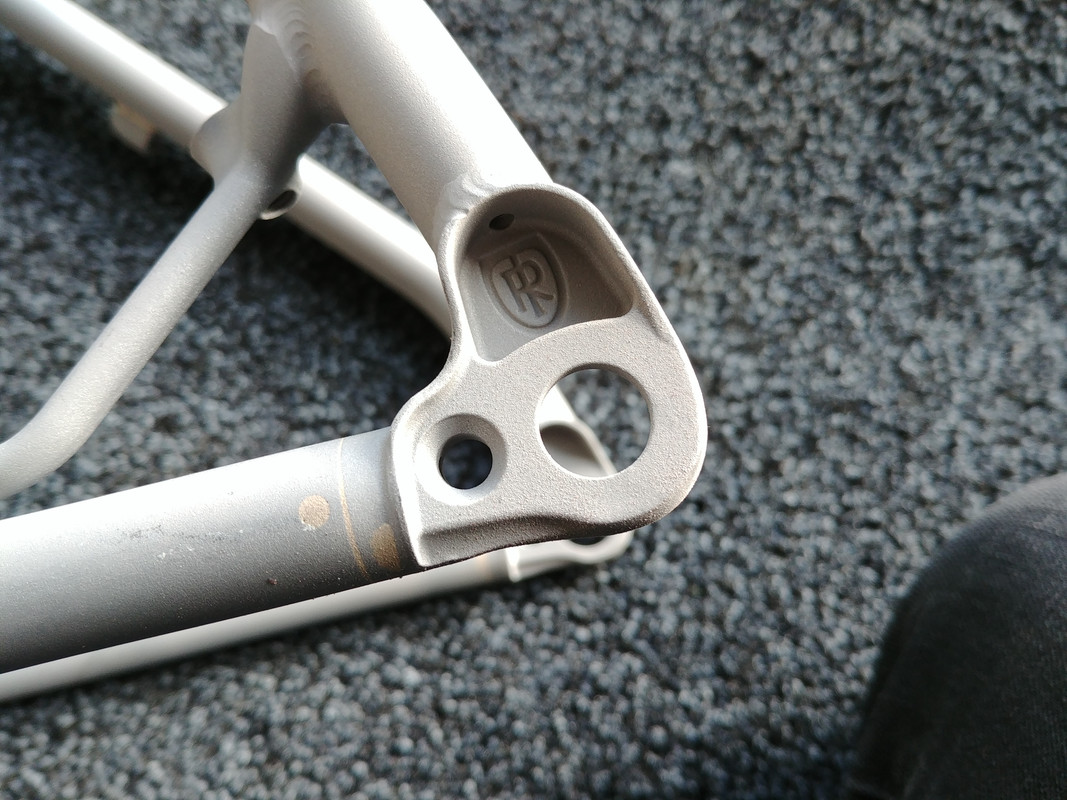

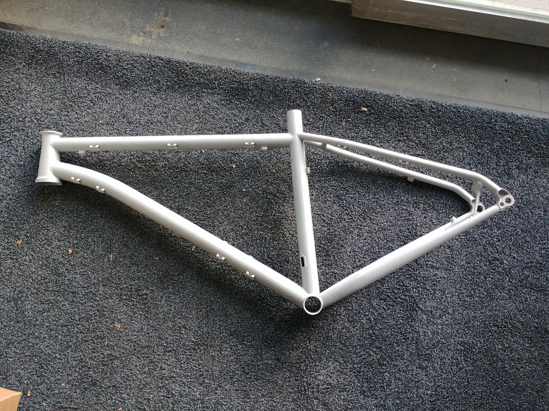

    So this build has already gone much further.
    The company doing the polishing and chroming did not live up to their side of the agreement, so I picked up the bare naked frame a couple weeks ago.
    I had decided to do the polishing myself and tooled up for the job. After about 14 hours of sanding, we are now here:
    The only thing needed now is a final fine sanding and then polishing. At that time the frame will go back to Walt AG for chroming only. At this point I don't care how long it takes them.
    The hubs were delivered to the house next door, which no longer exists, and then went back to Germany! Ha! They had sent them to my old address which is across the street and is now a construction site. So the wheel build is delayed, but I still have to polish the rims up, so we've got time.
    Next on the list, after the frame, is rims and getting the fork/seatpost sanded and prepped for painting.
    The shinier the frame gets, the more excited about the build I get.

    I should have weighed the frame before sending off for chroming this past Saturday. Oh well. It probably weighs a good 100g less from all the sanding! I am quite honestly a bit skeptical of the frame now and plan to put it through a bit of a stress test before taking it on any real rides. I sanded. And sanded. And sanded....and sanded....
    Here's the frame before I packed it up:

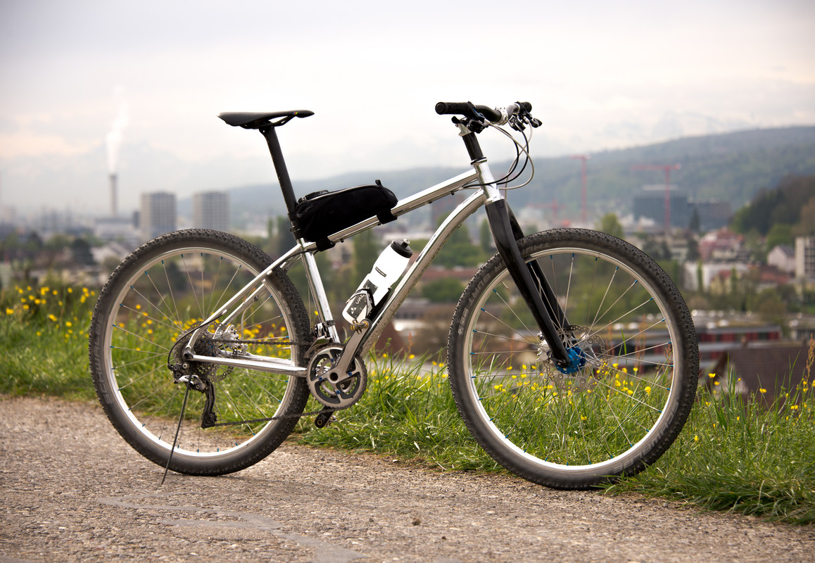

    Reputation: pressed001's Avatar
    Jan 2014
    189
    Took her on a test run today:
    This bike's geometry is very different than the 1995 GT Tempest that I usually ride. So the ride will take some kilometers to get used to. That said, I took it out for a 40km ride today with 900m of elevation gain (and then loss!) and I must say that this bike is almost nearly impressive. I honestly can't say that I'm too impressed with the frame, but it aint bad. The build is but top notch and exactly what I needed as an upgrade to the GT.
    First off, the disc brakes make downhill an absolute breeze. With 1 finger I got all the power I needed. The wide(er) wheels allowed me also to run less tire pressure on my tubeless setup which allowed better handling and grip.
    The steel frame put together with the low tire pressure makes this ride feel like it has a suspension. With the front tire at 1.8bar and rear at 2.0, I took some seriously rocky terrain at speed and didn't feel a thing. This is where I was impressed.
    The frame itself is just okay. Nothing special. But damn it looks good.
    Note: chainsuck 3 times on the ride today gave the chain-stay it's first scars.
    Plans: My wife was right, this bike would look great in all-silver. I will sand the fork and seatpost before bringing them to my favorite auto shop for a professional paint-job of the most metallic, chrome-like paint they can do.

    In summation: this is my new favorite mountain bike.
    Reasons: Wheels and brakes.
    Wheels: the wider Crest mk3 rims allow lower tire pressure which gives me more grip in the climbs and more cushion for the downhills. With reduced tire pressure I could effectively attack out of the saddle in the climbs without sacrificing much grip. I broke my old records for some local climbs already.
    The rocky and semi-technical downhills were much easier due to the superb braking power offered by the Magura's. The carbon fork, handlebars and lower tire pressure sufficiently damped the vibrations so that I could move with speed.
    The frame itself took me some getting used to. Initially I was very disappointed but found that most of the nervous feel was caused by an over-tightened headset. Once that was solved, the bike handles and steers well. I found myself attacking the hills successfully out of the saddle much more often than usual. Some of this can be attributed to the frame, but mostly the wheel/tire/pressure combo.
    Frame: Ritchey Timberwolf size M (purchased for $300 due to defective paint), stripped, polished and chromed
    Fork: Carbon AliExpress 27.5 15mm Thru-Axle
    Rims: NoTubes Crest MK3's, stripped and polished, tubeless
    Hubs: White Industries XMR 15x110 and 12x142
    Spokes: Sapim CX Ray
    Nipples: Sapim Polyax Alu 14mm
    Tires: Schwalbe Thunder Burt Liteskin Tubeless
    Crankset: XTR M980, 28x44
    Cassette: SRAM XX1099, 11x36 (purchased used)
    Chain: Shimano XT CN HG-95
    Shifters: XTR M980, 2-3x10
    Stem: Ritchey classic C220 100mm
    Handlebars: AliExpress Carbon EC90
    Brakes: Magura MT Trail SL with extra double caliper for rear
    Discs: Hope 180mm silver
    Brake-levers: Magura HC3 (purchased used)
    Brake-lines: Uberbike stainless kit
    Pedals: Crankbrothers Eggbeater 11 Ti (purchased used)
    Saddle: Ritchey WCS carbon streem
    Weight: 9.3kg with pedals
    Cost: ~$3,000
    At a later time I will sand the seatpost and fork before having them painted to match the chrome frame. But for now, this build is finished.
