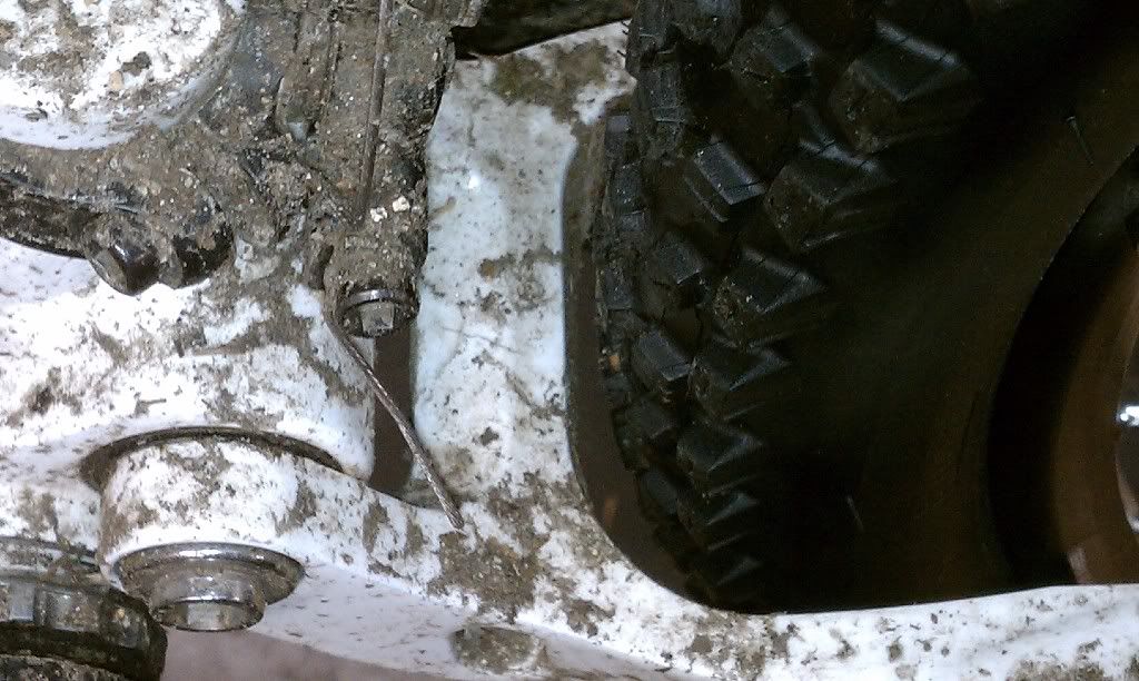

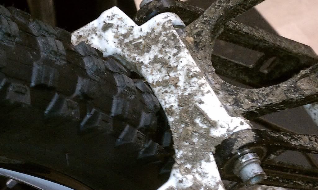

    Hey Mark,
    as requested I test fit a 650b wheel with a 2.1 Nevegal on it but unfortunately it doesn't quite clear the seatstay bridge. Plenty of clearance on the swingarm though.
    Seatstay
    Swingarm

    It would slacken your HA a little and raise your BB a little also but you would get a better roll over effect.
    I actually am running my Chili as a 650B and like it. I can only get a Maxxis Crossmark 2.1 to fit on the back tho.
    BB is 14in. which I like cause I was getting pedal strikes with the 13.5in. BB in steep mode. Using an Ardent 2.3 up front on an Avy'd Fox 36RC2.
    This tire combo might not work well in rocky areas as they not be tough enough, but in the PNW it works very well for me.
    I should add that I only have 3mm clearance on the seatstay so I won't be using this set-up when the mud comes out. It really packs it up.
