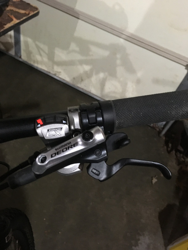

    Did some upgrades when the kiddos allowed me time.
    Raided the spare parts bin for some hydro brakes and better shifters. I swapped the XTs onto my wifeís SC Julianna, and put her LXs on the beater.
