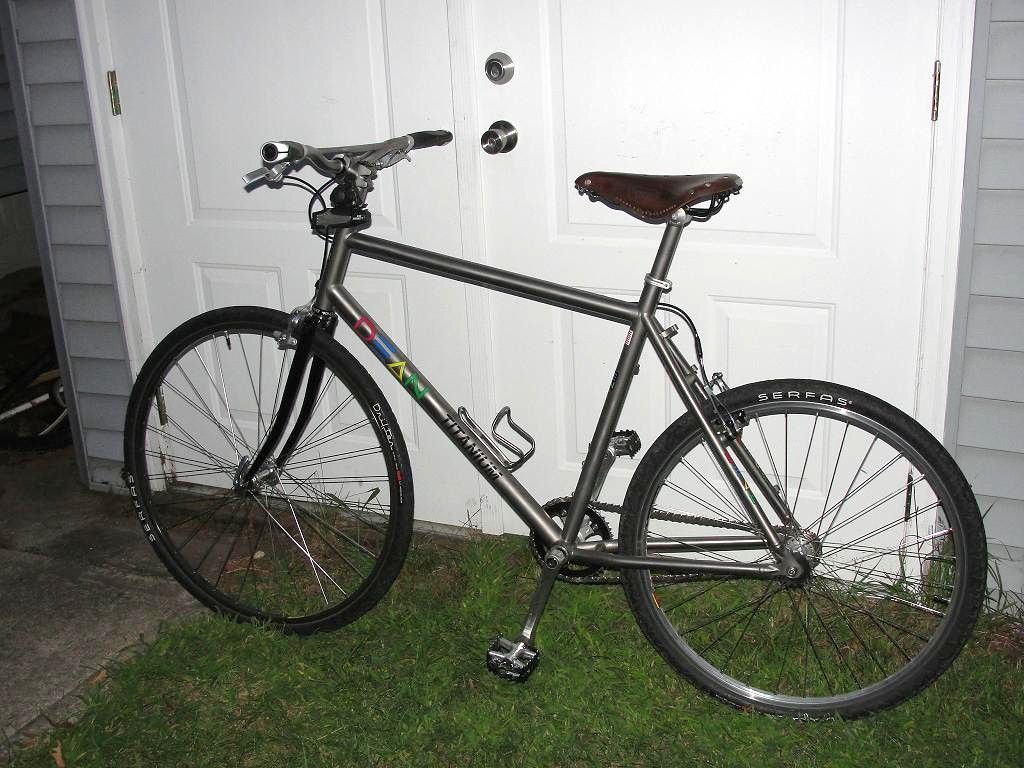

    OK,...here's an overall view of the bike to wet your appitite, but i will offer some additional pictures of some of the details i have been fortunate to find. I'll mention prices where known also, if only to show what you might expect if attempting something similar.
    Drive side:
    Non Drive side angled:
    Now, for a bit more details.
    This "FrankenRider 69'er" (lol, i like the sound of that,....just thought of it too :-) started life with a very nice used Dean Colonal 26" MTB frame. These earlier frame are SO reasonably priced i just couldn't resist, and own 3 total, one each in Medium, Large, and XX-Large.
    This single speed is built up using the Large size Dean frame, and cost just $545.00 shipped. All three of my Dean Colonal Titanium frames were acquired on ebay, and all have the older traditional seatstays and not the later wishbone seatstays which i just don't like the look of.

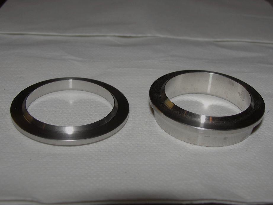

    I ordered the optional 5mm higher stainless steel baseplate ($25 or so shipped,....aka a "crown race" anywhere else) to begin to get this bike up to a suspension corrected state.
    Here's the usual baseplate compared to the 5mm height one:

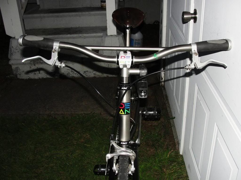

    About a month ago i found a no longer made Moots braced riser Titanium MTB handlebar, and it's a shame they don't make them anymore. I negotiated it down from "moon money" of $600 to a more reasonable "bend me over" price of $400 shipped :-)
    Not cheap for sure, and more than they cost originally too,.....but as they can't be ordered anymore, i paid the price. As a side note, it's worth every dime! The Ti absorbs a lot more of the road chatter and bumps on the sidewalks where i usually commute. No choice in my area.
    Here's a pick from the front of the handlebar:

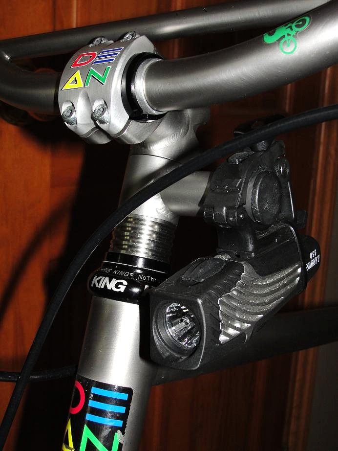

    One thing bothered me with this bar, my NiteRider Lumina 650 light ($175 new) mounting clamp wouldn't fit under the braced area, and mounted outside the center area would not face straight ahead.
    Here's the only way my light mounted previously, .....as you can see it's at an angle and i was losing some of the left side light coverage.

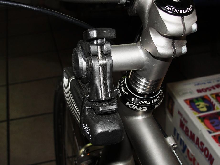

    SO,.....I contacted Ti Cycles and told them what i wanted to do, and they built a custom Ti 30mm headset spacer with a cool 2" tube section welded on at a 90% angle. It works GREAT, and looks nice also. An added bonus is i can flip this bike over in the house to rest on the grips and seat, as storage for 15 bikes is getting tight around here! The light mounted on top of the bar wouldn't allow that, even if it had pointed straight.
    I'll cover this in a bit of detail in case others have had a similar problem. An aluminum version would be much cheaper, of course.
    Here's a few pics of the light mount up close ($110) (and the back of the custom ordered but unused Dean Ti 50mm MTB stem i found on ebay ($275):
    From the front:
    From the side showing the 2 texture Ti Cycles Logo:

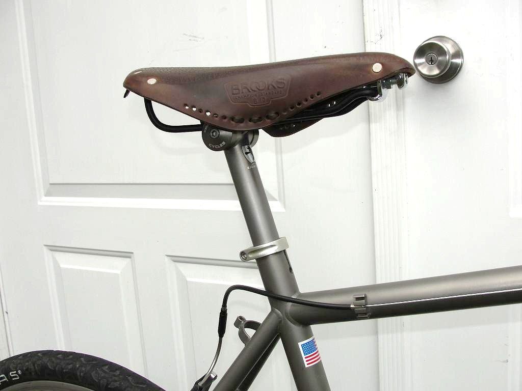

    A few months ago i found a very nice used Kent Eriksen Ti seatpost ($168.00), and the bike instantly became a noticably more compliant and comfortable ride. The Brooks B17 saddle($110) was also used with the stiffer Thomson Elite seat post i had been using, but i was surprised at the difference..
