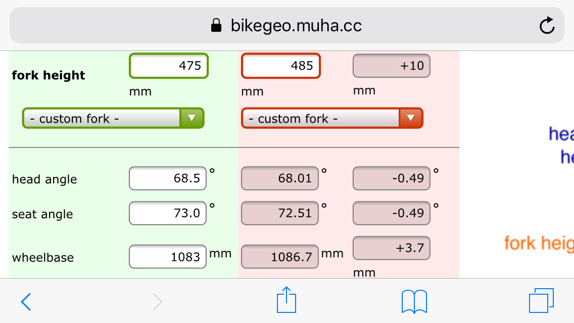

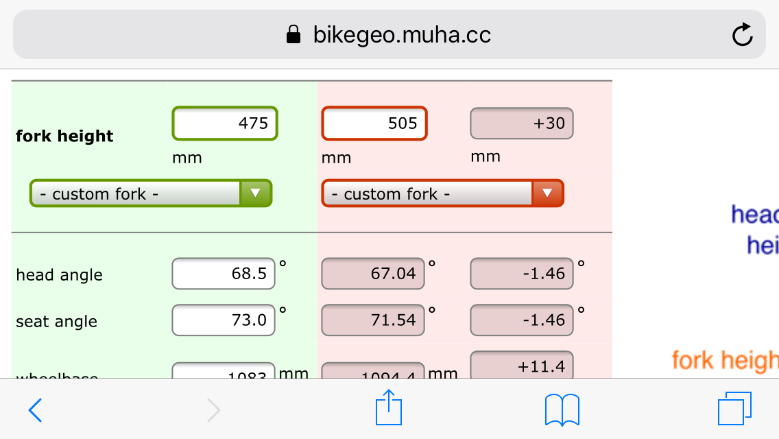

    Running the Reba with 29er legs at 80mm will net me a ATC of 485, 100mm at 508. Stock 27.5 suntour 100mm fork is 495 ATC, but small frame has 80mm so Iím at around 475 ATC (M-XL pitches have 100mm forks stock). Specializedís site shows a 68.5 degree headtube for all sizes.
    To get this out of the way... Why do this? Because a $200 set of lowers makes a way better 80/100mm fork than a $200 100mm fork out of the box.
    Ran the numbers for a 29er Reba for 80 and 100mm.
    My old school brain says wayyyy too slack, but this new geometry is making me a believer, so I donít know.
    80mm stocker -> Reba 29er at 80mm
    80mm stocker -> Reba 29er at 100mm
