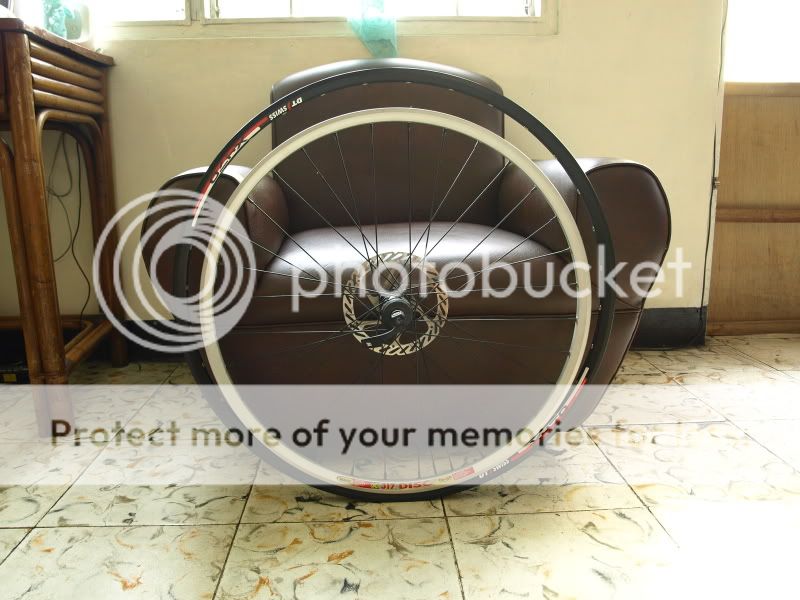

    Rim choice: DT Swiss X470... nice and light.
    Like a circle in a spiral...
    Big Wheel

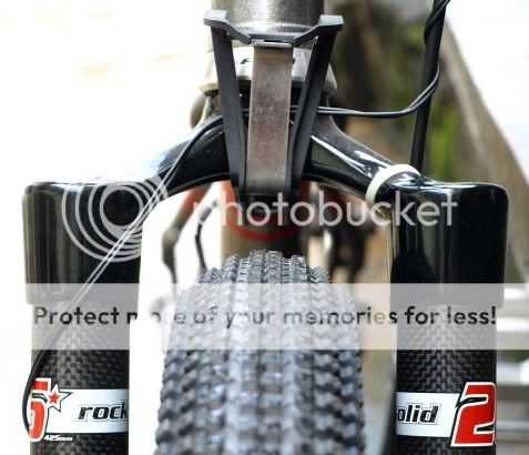

    We have clearance, Clarence... (WB Rock Solid, 425mm a2c)

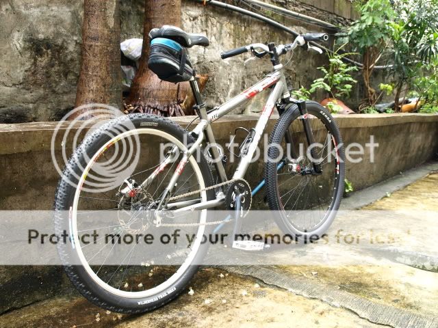

    SS Ruth 69 -- not your grampa's Penny Farthing.
    Here are a couple of "before and after" shots. Sorry, but these are the only ones I have.
    -Before-
    -After-
    I was thinking of replacing the rear rim with a black one, but figured I didn't want to spend any more than I already did. And, apart from the mismatched colour, the Mavic works perfectly fine (and light to boot... ~400g!).
