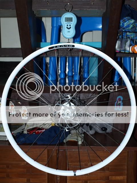

    Whoa... and I thought my wheel set was heavy:
    Rims: Velocity Blunts
    Spokes: Sapim Race
    Nipples: Sapim alu Polyax
    Hubs: Vision 360 (locally-branded, made by Taiwanese brand Da Bomb)
    Front 980g
    Rear 1240g
    Total would be 2220g, less the ~180g rotors = 2040g (~4.5lbs).
    Most of the weight is due to the hubs (similar weight to Shimano Deores), what with sealed cartridge bearings and a steel freehub body.
    I didn't weigh my tires, but going by published estimates, 750g for the Neo front and 550g for the Quasi rear, plus 2 tubes (~400g) would get a total of 3740g (~8.2lbs).
    FWIW, these go on a converted to SS Schwinn Moab 3. I hope to get some decent shots of the whole bike and post them as soon as I get the chance.
