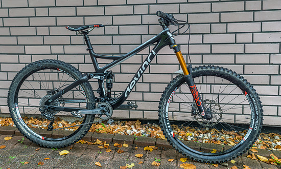

    Since there is talk of going 150 to 160 up front, I'll share my 160 to 150 observations.
    I received the frame last season and swapped parts from an Intense T275c to the carbon Troy. I ran the Pike in the 160 setting until the snow hit. I managed to get 3-4 good rides in during that time. With the stock shock (51mm stroke) I didn't feel the bike was performing well on the flats or climbs. It just didn't seem to want to accelerate like the T275c did. It's hard to explain but I felt like I was pushing against the forward momentum while I tried to pedal.
    I purchased to 150mm air shaft over the winter and installed it. Since the snow has melted I've had over 10 good rides and feel the bike accelerates much better on the flats and climbs very well. With the lowered front end and steeper HA I was concerned it may not descend as well but, I'm please to say, it still descends like a champ. The bike feels more playful and better balanced.
    I think if I ever went with a 160 fork up front I'd definitely throw on a 57mm stroke shock.
    Also, just have to say that the cornering on this bike is incredible.

    Pic.

    Well, after a year of slowly upgrading, i think shes about done. Just added the new light bike 38mm wheelset yesterday.
    Light Bike 38mm wheels with Hope Pro 2 hubs
    Maxxis High Roller 2 2.3 tires
    Enve DH bars cut to 760mm
    Race Face 50mm Chester stem
    ODI Grips
    Shimano XT Brakes with 180mm Ice Tech Rotors
    Race Next SL Crank with Direct Mount Chainring
    Race Face Affect Pedals
    Rockshox Reverb 125mm Stealth Dropper
    Cane Creek InLine DB Shock
    SRAM PG-1070 Cassette
    Race Face Affect Seat
    Still using the stock X7 derailleur and Shifter, they work perfectly so no need to upgrade at this point. Absolutely love this bike!
    Attached Thumbnails Attached Thumbnails 2014 Devinci Troy quick review-img_20150531_115137880.jpg

    New Troy on site
    DEVINCI

    My Troy, i love the agility of the bike. But it could have a longer toptube.
    It does look sharp with that fork. Do you like the Frequencies on it? That's likely the rim I'll build up soon.
  147. #1547
    18
    Thanks. Yeah i have the i23 since July 2014 in use. With several hangups, boulderfields, drops,gaps. No problems yet.
    I totally recommend them.
    But i have a really big vibration while braking with the rear brake. Its so strong it vibrates through the whole frame.
    I didn't had that problem with my GT Force.
