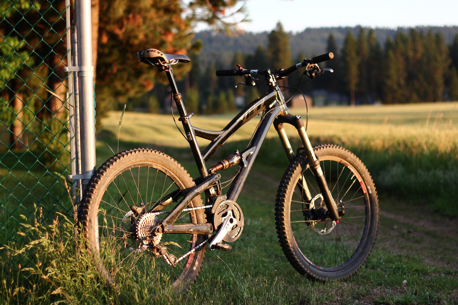

    Nothing too radical here...
    2012 SB-66
    • Race build kit
    • Answer Protaper Carbon 780's, cut to 760mm (*great* upgrade!)
    • Joplin dropper
    • Cheap VP 001 pedals. Finished them off today as they are now smashed and creaking. Just ordered Canfield Crampons
    • Stan's tubeless
