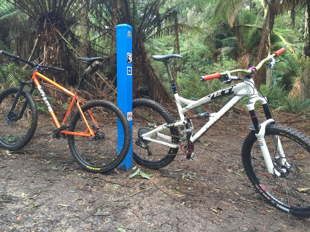

    The Big Chook followed by Atlas, Derby, Tasmania. 50km loop, needless to say I was less beat up than Benny on his rigid SS.
