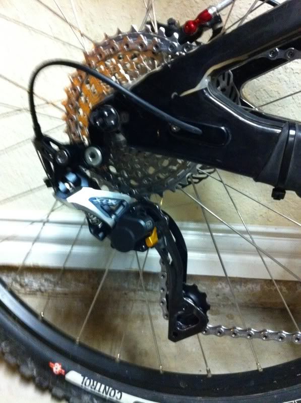

    im thinking of converting my 11 575 enduro to a 1x10 and Gamut p20 single guide.
    can i remove my big and small ring and convert? or will i need a specific single crank setup?
    post pics of what your setup if you have.

    I have been running 1x9 on my asr 5 the whole time that I have it with no issues. I have a couple of buddies running 1x10 on the '11 575 as well. One with a gamut p20 and one with an e13 lg1.
    As far as any specific stuff, you can run your current middle ring, but it works even smoother if you get a non ramped ring designed for chainguide use.

    I am 1x9 with Gamut set up, wouldn't go back!
    Is as simple as taking the outer and granny off, fitting bash and guide then you're good to go!

    i went with it. Gamut p20.
    fits good an everythings smooth. there is literally 1mm between the granny bolt studs and the guides bolts lol. super close but it fits.

    Sweet! Depending on how soft you have your rear shock, you may need to rotate your guide clockwise to stop the chain rubbing on the the top bit when riding.
    As I don't have ISGC mounts, I spent a lot of time taking crank on and off to make fine adjustments
    Enjoy your new silent ride!

    Don't you have ISCG-adaptor? Do not need to adjust by taking of crank then
    122
    Yeah, found out about them after I'd bought and fitted the device! At least when you have it dialed, its fit and forget.

    Yea i played around wit it.
    its fitting nice and super silent!

    I've been running 1x10 on my 2011 575 for over a year.
    Raceface narrow/wide 32t, 11-36 cassette, Zee wide range mech and shifter. Most importantly no chain guide. Never had a dropped chain once.
    Unless you really feel the need, I'd go without a guide as the narrow/wide ring combined with a short cage mech and clutch really do a great job of retaining the chain.
