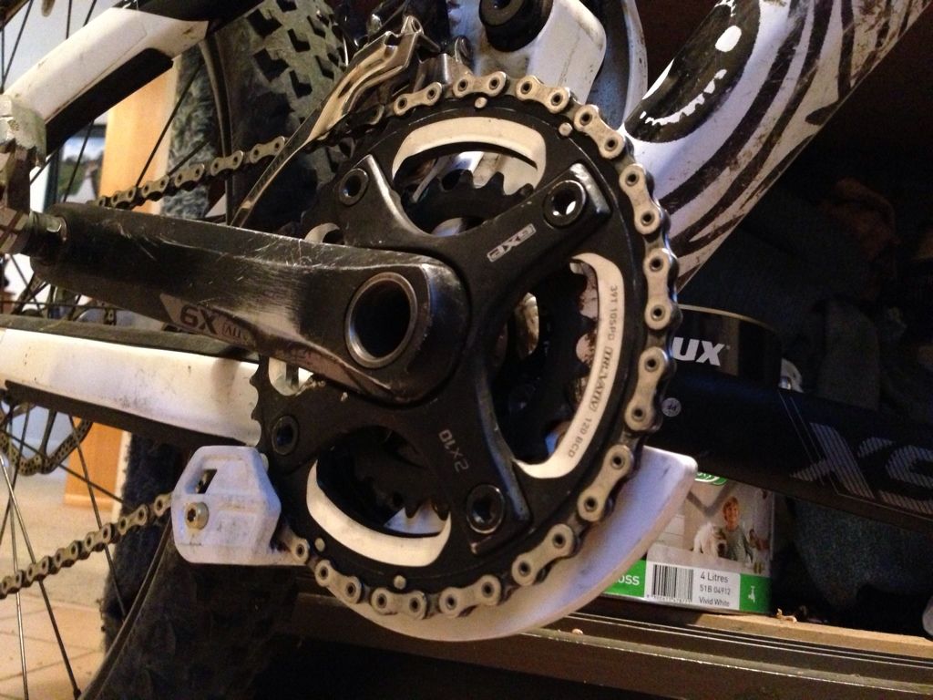

    I put the splines on my sb95 and am running an MRP XCG on it (I have a separate tensioner, the Bionicon). If you're running the "clutched" rear-d then the XCG is a nice bash option to protect the rings.
