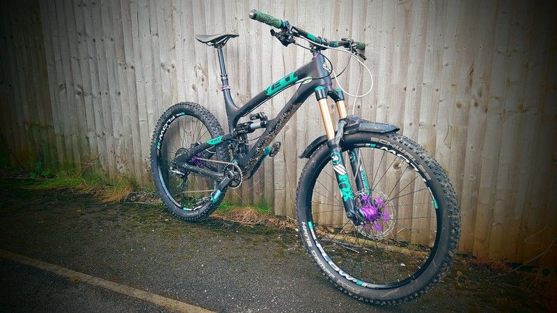

  14. #714
    May 2012
    99
    just thought i'd leave this here, it's my 66c with its new Christmas wheels:
    i plan to run this bike until it becomes beyond uneconomical to repair, i love it...
  15. #715
    Reputation: bridgestone14's Avatar
    Mar 2005
    915
    Where did you get the purple headset?
    Live fast, Die young, Leave a good looking corpse!
  16. #716
    May 2012
    99
    it's a chris king one that i bought from a guy on this forum... i think hope are about to start releasing theirs in purple, there's also a company called sixpack that make them in purple, i had one for a while and the colour match was perfect for the hope/king stuff, but as soon as i got it the king one became available so i never actually got round to fitting it.
  17. #717
    Mar 2005
    915
    Nice, I have a set of purple king hubs but never was able to find an inset 3 headset to match. I will check out sixpack.
