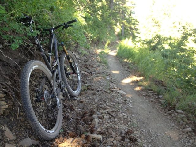

    Feb 2012
    129
    Rebuild
    Rebooted my 2012 sb-95 race! Rear shock kept cavitating, so Fox gave me a deal on a float X. So, i figured i'd also buy a new pike to go with it. Build is otherwise stock, except tompson dropper and carver carbon rims laced to king hubs with sapim x-ray spokes.
    Keith in Corvallis
  5. #355
    Reputation: bike21's Avatar
    Feb 2006
    427
    How is the Float X feeling?

    Quote Originally Posted by bike21 View Post
    It feels like a slightly reserved version of the float. It isn't stiff at the top of the travel or anything, but it doesn't give up any more than it needs to. The upshot is that it's very well damped in the second part of the travel. In other words, I'm loving it, especially with the pike!
    Keith in Corvallis
