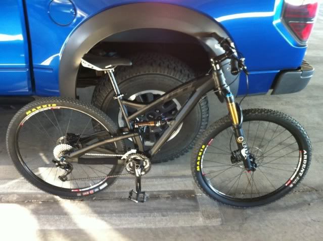

    Clyde Rolling on a Yeti SB95
    Just got her home!!
    It's my Christmas gift from my wonderful Wife...Thank You so much!!
    Now my truck and bike is rolling on Fox Shocks :thumbsup:
  • 12-11-2012
    icelt
    Hearty congratulations! This past summer I picked up a 2013 Big Top race build and have loved every minute riding it this past 5-6 months. So I can only imagine the joy you'll experience peddling around on a FS Yeti 29'r. :D
    Alas there is one specific thing I have not loved about it and that is the DT Swiss XR400 rims and I'm not the only one. I hate to rain on your parade a bit here, but already I have experienced 2 dents in the rear and have had it professionally re-trued. A mere 3 rides after truing, during which I kept the air pressure around 38-40 psi, it has again developed a significant hop and even the front wheel is beginning to wobble a bit.
    TBH I'm pretty frustrated and disappointed with the rims considering how much I spent on the bike. I will soon take my concerns up with the Yeti warranty department and we'll see how that goes. So all that being said, if I had to do it over again the first thing I'd do is Ebay the stock wheels and use those funds to acquire a much more durable set of hoops.
    You may have better luck given that your rear rim is better protected by the SB suspension, but there are at least 2 other guys on the forum with SB95's who've experienced similar issues with the XR400's.
    Hopefully I haven't brought you down, the rest of the bike will be phenomenal I'm certain, but being as you just received it you still have a chance to be proactive regarding the wheels so I wanted to at least make you aware of the concern. :thumbsup:
