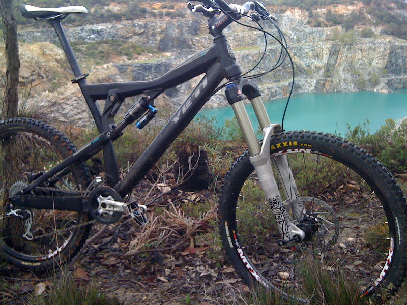

    61
    Any photo with spring ....Fox or CCdb???
    338
    I have one with the Vivid...
    61
    Thanks for the pic..!!
    You use it with air shock??
    You could comment sensations air vs coil???
    That weight ?
    Thanks again.
    338
    I use the air for XC and coil for FR and DH. I should really just stick with the coil shock. It is so much smoother, and never bottoms out. I think tiggs got his Vivid Pushed, and liked it even more. I was thinking about doing the same, but someone at Push replied to my email saying they were almost ready to Push the Monarch and I should wait. That was several months ago, though.
    I bottom out the Monarch regularly on XC trails. It's way stiffer than the RP23, though, and more than a pound lighter than the Vivid. It handles small bumps pretty well considering I keep the sag at about 10%. It has a certain range, say, when riding down stairs, that will shake your fillings out if you take it at speed.
    Except for the weight there's nothing about the Vivid I don't like. I swapped the DHX coil for a Vivid on my ASX and liked it so much I started with the Vivid when I got the 7. The RP23 lasted just long enough for a test ride around the house.
