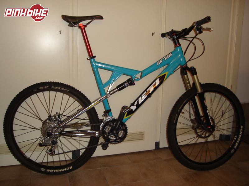

    And where are the pics?

    The few i made yesterday are really poor quality, but if you push me
    The red seatpost is going to be replaced by a black Thomson and the crankset will be replaced by an Deore XT HTII version.

    Now that's a looker!
    How does it feel with the Reba? I have used my Pike at 110mm, but only on really steep climbs...

    The Reba feels good so far (rode only a mile or so)
    Had to wind it down to 100mm to get a more XC-racy feeling, but at 115mm it was good as well.
    Not much of experience so far, but i'm sure i will in the near future
