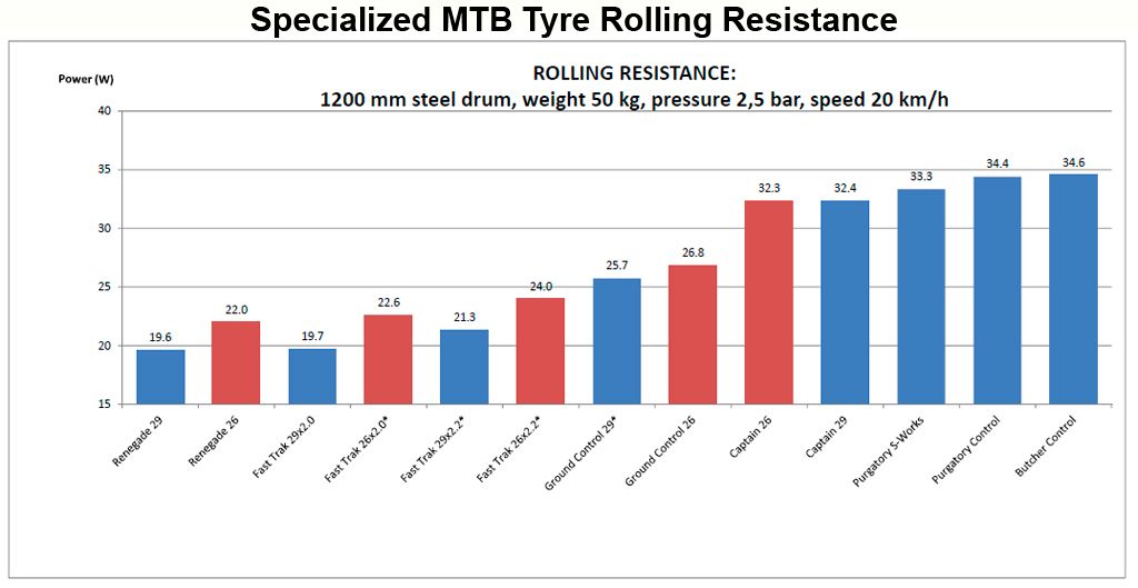

    I completely agree. For me, with a limited budget, I tend to look at a graph like that, and can pick out which tires which have have the smaller knobs that I know wont work, then look at the ones I guess will have enough traction for my requirements, then pick one with a better rolling resistance to try out.
    a graph like that just helps me narrow my selection down to the next tire im going to try..

    Quote Originally Posted by wetpaint View Post
    Do we know where this graph came from? The reason I ask, is that looking at the Ground Control tire in my garage and comparing it to the Purgatory, they are fairly similar. The Captain looks like it should have a lower rolling resistance than either of those, but the data in this graph does not support that. Also wider tires are supposed to have lower rolling resistance than narrow tires, because of less deformation, and this graph is the opposite when comparing two widths of the same model...

    Quote Originally Posted by rdalcanto View Post
    Yep...I'm wondering the same thing???
    Specialized use Wheel Energy for their tyre testing.
    http://www.bikeradar.com/gear/articl...e-myths-29245/
    http://www.wheelenergy.com/

    Tire width, pressure, and compound seem to make far more of a difference than the tread design, in my experience.
    I'd love a RK or Shield WCS-like tire from Schwalbe. They have awesome rubber, but their side knobs are too long with too little support. They either fold, or in other people's experience, tear, under hard cornering.
