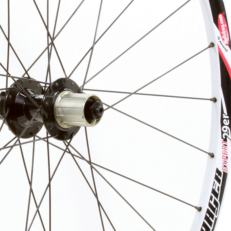

    On Sun Ringle's website it says you must specify QR or 15/20 and they are not interchangeable like the other models. Can anyone confirm this? or am I mistaken.

    I was considering going into a little plastic debt on this one, but saw that it specifically says not convertible to 142x12 (honzo's on my radar for this spring). Do you know anything different? I don't see where it says 2012.

    Those are equal the Flows. The Black Flags are more like Arches. As for the 2012 bit, those are 2012 hubs, which are similar to straight-pull design which still use J-bend spokes. And I'm 99.99% confident they are easily convertible, inquired about this a while ago while asking about freehub bodies for my 2011 set.
    2012
    2011 hubs look like this and are not convertible.

    The chargers with the straight pull spoke are 2012 and are changeable to 12x142. I have these same wheels (26") on my Chilcotin I just built. You just need to buy the endcaps for the rear as they dont come with like the front.

    still confused I guess... the rear hub on the product page looks like the one described above as not convertible and the rim matches the 2012 (as above^^)

    If you notice in product description at the end it links you to buy the 12x142 end caps for the rear. These are convertible.
    What they list on the product page:
    Looks exactly the same, focus on the hub itself. What may be confusing you is I used a 2012 front hub pic and a 2011 rear hub pic. Ignore the freehub body for now, those haven't changed.

    Thanks for the clarification guys. what had me confused is that when you click on the features folder on the product page, the last feature says not convertible to 142x12. Must be leftover description from the prior years model?...

    I did some research and read somewhere that the 2011 Expert models were only 9 or 15/20 specific and not convertible to 142/12. The 2012 models supposedly come with 9/15/20 endcaps and are 142/12 convertible.
    Now the way the product title(15/20) on the website is worded, it sounds like they might be 2011 models.
    I also read that someone had the 15/20 2011 models and ordered a Mavic endcap that converted theirs to 9QR. Either way I took a chance and ordered a set.

    I called Arts yesterday asking about 142X12 compatibility. The guy did some checking and called back. I was told these are 2013 model wheels (the OE 26 & 29 versions) that Intense was dumping as they are apparently going to a different wheel supplier. It was also confirmed that the 142X12 endcaps work on these wheels as they physically tried it before returning my call. I did not ask any questions about front hub compatibility 'cause if it covers 15/20, I'm satisfied. This sounds like a very good value in a highly flexible wheelset. I'm not sure that I really need them but could use a set in 26 and 29! Decisions...
