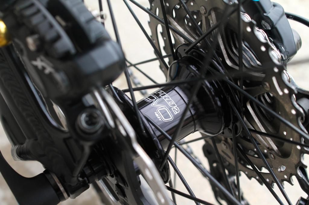

    DT Swiss got the vote for weight, serviceability, and reliability in the hub department - 240s c-lock, thru axles:
    WTB KOM 29" Rim - wheel build review-dscn6937.jpgWTB KOM 29" Rim - wheel build review-dscn6938.jpg

    Got a summer's worth of riding on these and I'm very happy with them, so happy that I've built another set with their KOM i25 rims and 350 hubs this time around. Wheel set weight is hovering just over 1800 grams (29") with c-lock hubs, DB wheelsmith spokes and brass pro lock nipples. Geared more towards enduro or trail use this time.
    The original wheels posted in the thread have required little maintenance and while I haven't pushed the envelop with low PSI I'm not running anything higher than 20 psi even for racing (I'm 160 lbs) so I'm pleased, no dings, rolling true. I ride fairly technical trails when given the chance...
    With these new wheels I plan on abusing them a bit more with lower pressures to improve some DH times... and fun. The build is decent but I am concerned with the seam, heat sink, weld as after bring the wheel to 120 Kg drive side I'm getting what I hope is only paint cracking right at that seam. I'm a little wary of this but I'll keep this thread updated.
    As an aside I'm finally going to adapt these dt hubs to the 36 step star ratchet as they are SLOW to engage with the 18 step... hope it makes a noticeable difference since that little upgrade retails for $120!!!

    I've had my 650B KOM i25's on for a couple of months now and have loved them so far. I've even managed to case a couple of jumps and ended up with no dents thankfully. Can't remember what mine weighed exactly though. Hope Pro Evo 2's front and rear with DT Swiss spokes and nips.
