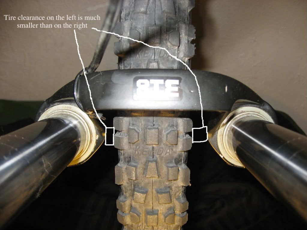

    Why do my wheels always veer to the left?
    Brand new wheel from BWW, i installed it and it was more or less perfect, two days later (no ride time on it, i haven't even sat on the bike yet as i am still building the bike) and it ends up like this??!
    <a href="http://s241.photobucket.com/albums/ff133/combine97/?action=view&current=IMG_3725-1.jpg" target="_blank"><img src="http://i241.photobucket.com/albums/ff133/combine97/IMG_3725-1.jpg" border="0" alt="Photobucket"></a>
    i have verified that it's not just the tire, it's the rim... i also had this problem on my rockhopper and this one is a 20mm T/A!
    wheels don't just go out of dish... BUT THEY ARE!!!
    what the hell is going on? i had noticed that every so often i would hear a small "ting" from the spokes (not any more)
    rim is true but it looks out of dish

    hows it spin?

    very well, nice and smooth.
    rim runs true too

    have you checked the wheel with a dish stick/dish 'gauge'?
    1,236
    not yet, i don't have one. is there a way to do it without? i think there is but i can't remember how.

    you would need to manufacture a tool that worked in the same way. Take it to a lbs, they will have one.
    1,236
    darn... ANOTHER trip to the LBS
    on top of that i need to rebuild my fork... ahh well sh*t happens i guess.
    why would this happen though? i mean it just happened by itself

    Take the wheel off the fork and reinstall it backwards. If the small gap is now on the other side, the wheel is out of dish. Otherwise it's a fork issue.
    1,236
    ok, so i did that and i guess it's out of dish cause the gap is on the other side!
    weird weird weird... thanks for the tip!

    When the wheel was built, all the spokes were twisted up. The "TING" you were hearing was the spokes loosing that twist. When they go to a relaxed state - no twist from tip to tip - they "TING". The rim needs to be re-dished and might need re-trued/re-tensioned after your first couple of rides.

    Sounds like you got a very poor build, from missing the dish by a mile to inadequate stress relief (pinging), call BWW and get it sorted out.
