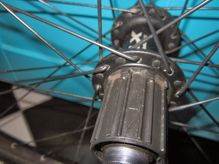

    I've had a similar issue with a Deore freehub body developing cracks and falling apart. Both times the freehub body was less than 3 months old (i'd estimate less than 100 hours riding). The photo below is the remnants of the freehub body after the first failure (heard a popping sound and the freehub locked up so that I couldn't pedal, cue a 2 hour walk home).
    The first time it was warrantied no questions asked as the wheelset was on a new bike, but this time I'm nowhere near a dealer (or even a bikeshop for that matter) that I could take the wheel to so it could be replaced through warranty. The second time it happened was a few days ago, and exactly the same thing happened again. I'm probably going to replace the whole wheel, as I just don't trust the shimano freehubs given my experience on them. Incredibly disappointed.
