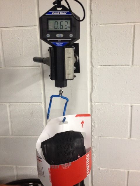

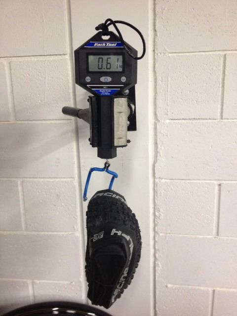

    Reputation: kevocastro's Avatar
    459
    So I went to my LBS just to realize my 2.4 RR is not that heavy, it's actually lighter than the damaged 2.25 RR
    2.4 Brand new
    2.25
    Fast Track Control 29x2.0
    Since the race is gonna be endurance I'm gonna keep the 2.4 RR at front, the large volume it holds might help me out a bit, I was all over the Fast Track but since I already got the 2.4 rather spend the money in something else
