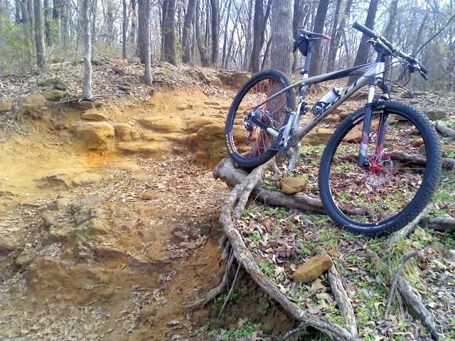

    This is my first review so bare with me and feel free to ask any questions.
    I'm using these on a Scott Scale Elite (L) with a Reba RL and Shimano QR skewers.
    I set these Pacenti's up tubeless with Stan's 25mm tape, just like I have with the Stan's and Sun Ringle wheels I have. I weigh 180lbs so, I set the front Rocket Ron at 24psi and the rear Ikon at 27psi and hit the trail, I will drop the pressures some on the next ride. My first impression was that the bike felt more lively and in contact with the ground. Rolling over roots and through ruts that ran along with the trail I didn't notice and flex or feel pushed off track, the wheels held their ground. On a few 1-2 foot drop off I hurdled off of the landings were secure even when it was a bit sideways. This is when I was expecting a burp or squirm from the tires but nothing of that nature happened.
    High speed cornering, the wheels tracked right over any rocks or roots that were in my line and no deflection was noticed. I used to feel the rear wheel quiver coming out of fast turns but not anymore, not with these rims.
    Overall, I am impressed and glad I bought these despite the lack of info and reviews. The 355s these replaced had hairline cracks around a few nipple holes that were hard to spot behind the rims stickers. The TL28 has eyelets so that isn't going to be an issue now. I added 70 grams total to my Industry 9 Ultralite wheelset and it was worth every bit of it. The added stiffness and width nullify the weight that was added by a long shot. I guess they are not technically Ultralites any longer but they are stout everything I wanted in a wheelset.

    I really like mine. Only a week on them but with I9s they are stiff, light and wide. I have Bontrager rim strips in them for bomber tubeless.

    I was hoping to have a better review by now, but unfortunately I only have about 50 miles on them - 30ish on mostly buff single track and 20ish on night rides.
    I am happy with them so far though. They are lighter than the Flow/Arch combo they replaced and are just as stiff. Ultimately time will tell how the hold up.
    FWIW, the reputable builder was impressed with their width to weight ratio and how well the tension balanced out.
