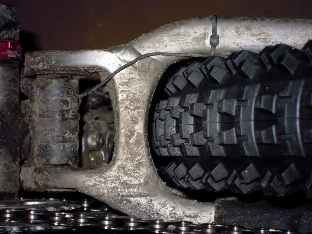

    Received my 2.4 today. Got only one for now, for the front wheel, as I wasn't sure about the rear triangle clearance. Turns out that the Telonix 2.4 isn't that big. Being new, installed on a ZTR Flow with a tube and pumped up to 35 psi, it measures 57 mm wide by casing and 61 mm wide by the widest knobs.
    Speaking of volume, Telonix 2.4 is a little bit smaller than Rubber Queen 2.2 (and I guess it will stretch a little over time, so they'll be almost the same volume), but has a wider tread. Pretty much what I actually wanted to try on the snow.
    Made a few pics. No width measurement pics, sorry. Need to get a digital caliper .

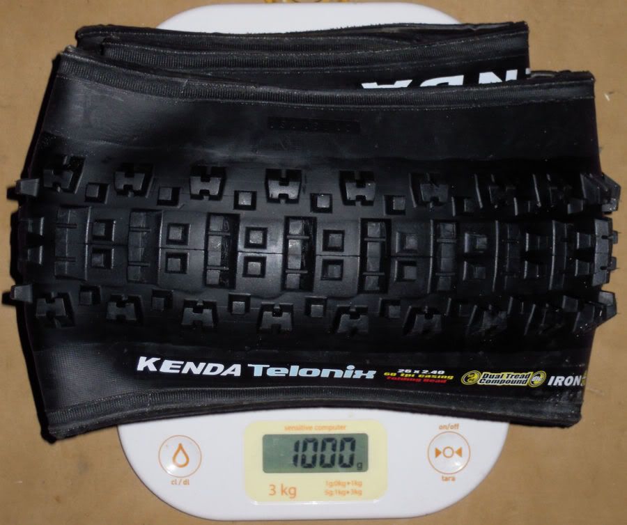

    Weight
    Trance X clearance for Telonix 2.4 (new on ZTR Flow, tube, 35 psi)
