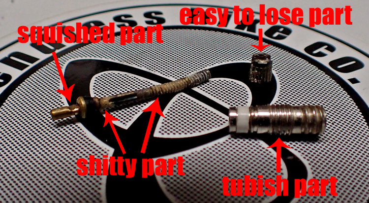

    Reputation: teamdicky's Avatar
    5,979
    Quote Originally Posted by MikeDee View Post
    How best to clean a clogged valve core? I'm replacing them too often.
    An excerpt from a past blog post:
    "You need to get a pair of pliers on the squished part, grab the easy to lose part with another set of pliers, and turn the recalcitrant bit off the top. It doesn't want to come off, but it will.
    Once apart, you'll see all the sealant on the shitty part and inside the tubish part. Pick, poke, stab, rub... whatever it takes. Get rid of it. Once everything is gunk free, reassemble and check to see if the easy to lose part will back off the threaded, formally shitty part too easily. If so, give it a little squish with your pliers and check it again. Repeat until the easy to lose part doesn't come off in your fingers."
