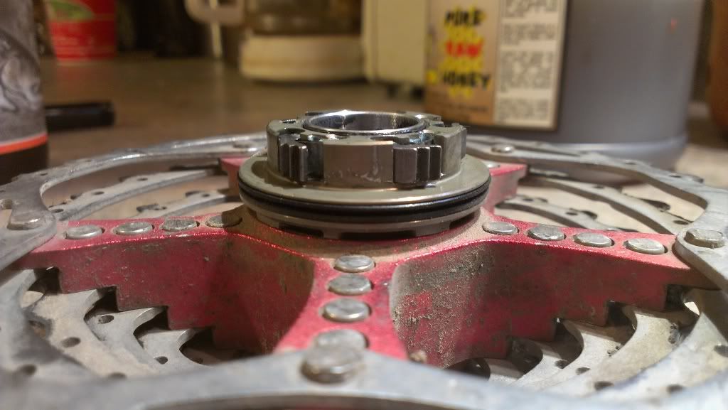

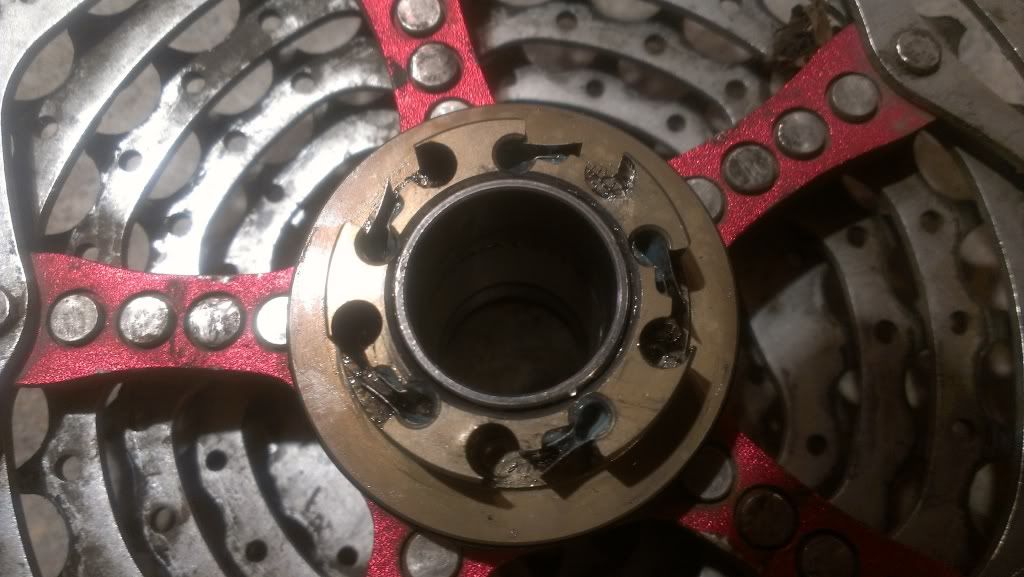

    Just happen to put another 4hrs. on the hub. and this was the result. i think the pawls are deflecting during engagement. probably not worth getting a new freehub body. if one part broke and the others are cracking. this might not be a deal breaker though. it may still function as designed. the material is really thin that broke off.
    i think some dremel work will prevent further breakage.

    Looks like the ring gear made contact with the freehub. Notice the vertical line/mark were the anodizing is worn off. This was a common problem with the previous version due to the axle flexing. I can't believe you are ok with this. Good luck.

    it's a 12x142 hub on a carbon frame flex is minimal. those are the only two areas that have the abrasion. and since i didn't ride it but a few miles after it started making noise. i'm going to assume it was the broken pieces. no other damage anywhere. the material is just to thin there not to have problems.

    Thats pretty common in all similar ratchet hubs. Either the metal fails there or the springs fail or the pawls themselves, or the ring. Its a flawed disposable design from the start. The only good hubs using this design seems to be WI and hadley, and shimano, but theirs is different.

    This has nothing to do with what I was describing. The hub axel itself flexes enough to allow the freehub to make contact with the ring gear in the hub shell. There is also signs of the ratchet paws "mushrooming" their seat in the freehub body. Anyway, good luck with that.
