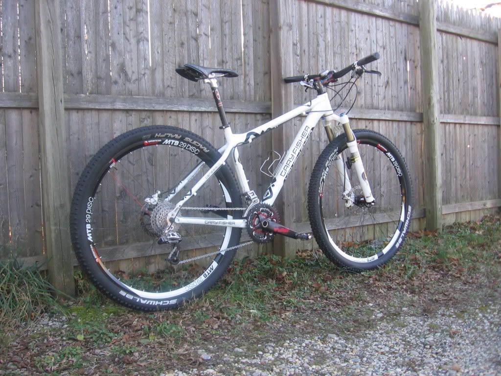

    Hello All: Nice thread. I have been running these wheels on an XL Air 9 hard tail for two seasons. I am 6'3 and about 190 pounds. I actually have two sets a 2010 and 2011. The wheels are awesome. Set up tubeless with conti race kings and mtn kings no problem. Have not touched the wheels and roll as true and smooth as the day I got them
