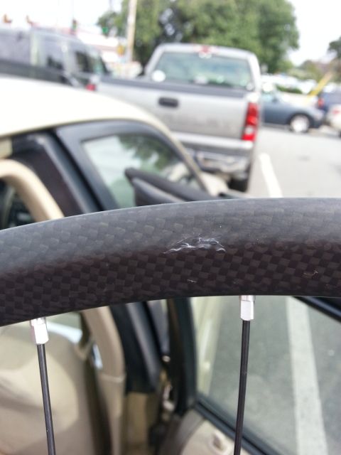

    For the first time since I started using carbon rims I hit one hard on a rock. I may have bumped one before but during my race run yesterday while running 28psi in a 2.5" DHF Exo I hit the front rim hard enouh to hear and feel that sickening thud of rim bottoming out against rock. At the bottom I examined it and couldn't even see a mark. This is about the hardest that I ever hit rims so I'm pretty optimistic that carbon will have no problem holding up to my riding. It was a 380g version of LB's AM rim.
