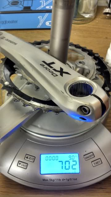

    Just converted to 1x9. Will be getting a 36t Chinook to replace the 40t and 28t currently on the xt:
    However I fancy a completely new crank to drop a few lbs. Preferably something carbon. I really like the s-works carbon but know that won't fit as I have a BSA bottom bracket and they're bb30.

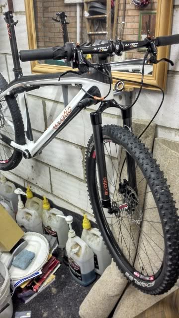

    It's to go on this:
    Let me know what you've all got or what you recommend. All input welcome! Thanks in advance!
