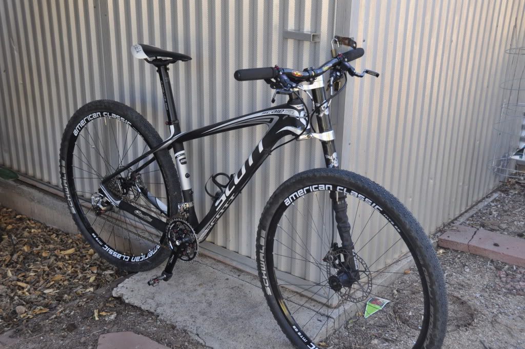

    2010 Scott Scale 29er Carbon Pro, SRAM XX, Carbon Lefty DLR SL
    This was by far one of my best builds, but most challenging. The Scott frame has internal cable routing that is a PITA. To run the cables you have to remove the cranks and the BB cups. Not a fan of that, but I shaved about 70 grams off the Nokon cables by having this option on the frame.
    Total Weight = 16.93 pounds / 7681g
    Built up at this test weight, but tweaking it as I ride to find the best parts for handling and comfort. Will likely end up around 17.5 pounds.
    Bottle Cage: Carbon Fiber 14g
    Bottle Cage bolts: 4 Black Alloy 6g
    Bottom Bracket: Shimano BB91-41, tuned 70g
    Brakes Rear: Ashima PCB=207g, Hdwr=7g, 160 rotor=81g 295g
    Brakes Front: Ashima PCB=188g, Hdwr=31g, 180 rotor=101g 320g
    Cables / Housing: Nokon Silver/Black Front=11+9g, Rear=19+12g 51g
    Cassette: SRAM XX 11-32=178g KCNC Black LR=4g 182g
    Chain: KMC X10SL Gold 208L 235g
    Crankset: KCNC X2 42/29 559g
    Derailleur Front: SRAM XX 2x10 Hi Mount Bot Pull 119g
    Derailleur Rear: SRAM XX 2x10 Med Cage F&N Pulleys=20g 178g
    Fork: Lefty Carbon DLR SL 29er air filter, mod boot 1211g
    Frame: Scott Scale 29er, CF Chain Gaurd 954g
    Grips: Extralite Foam w/caps 18g
    Handle Bar: Easton Monkey Lite SL 25.4 Black 126g
    Headset: KCNC Radiant Taper=65g, cups=24.5g 90g
    Headset Cap/Bolt: Tune Carbon=5.5g, star nut=6g 11g
    Headset Spacers: Carbon 40mm=14.1g, Project123 tube=172 186g
    Pedals: Egg Beaters 3Ti Red 188g
    Quick Releases: Rear Skewer Only 23g
    Seat: AX Lightness Sprint 70g
    Seat Binder: KCNC 38.2 Black w/red bolt 13g
    Seat Post: KCNC 34.9 x300 140g
    Shifters: SRAM XX Carbon 2x10 ti bolts F=95.7g, R=90.7 190g
    Stem: KCNC Bear Bones 25.4 x 90, 5deg Ti bolts 96g
    Tire Front: Schwalbe Furious Fred 29er 386g
    Tire Rear: Schwalbe Furious Fred 29er 362g
    Tubes: R valves =17g, R sealant=26g F sealant=26g 69g
    Wheel set (Front): American Classic, Soul Lefty 29er= 674g N/A
    Wheel set (Rear): American Classic 29er= 849g N/A
    Wheel Set (Entire): Soul Lefty cap and bolt=10 1523g
    - Hub Front: Soul Kozak hub with wheel build N/A
    Misc Option: KCNC Ultralight Steel Rotors 160mm/180mm N/A
    Scott Scale 29er with Carbon Lefty at an insane 16.9 pounds.

    Nice build and it looks good! Is that your actual seat height? Your handlebar ist higher than your seat. How do ride like this!? (considering your built, which is a CC Racer in my eyes)
