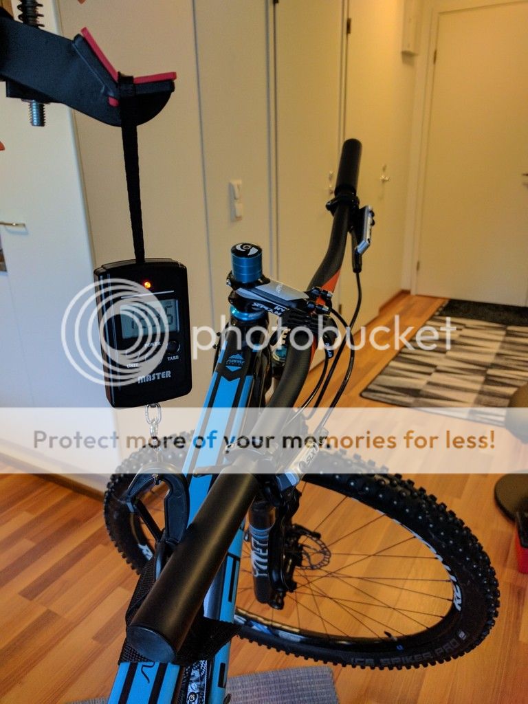

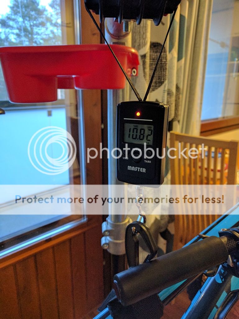

    New Build - Trek Superfly 8

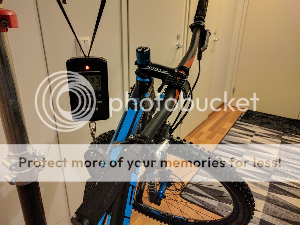

    First post on the weight weenies, so be patient with me!
    So after having had my first "better" bike for nearly half a year now and having acquired all the necessary gear I can finally focus on the bike more. Being a full time student with a minimum wage part time job my budget is very limited and hence I'll go with cheaper upgrades in the beginning and in the summer when working full time I can look into bigger upgrades, such as wheels and even possibly a carbon frame. So:
    Current weight: 14.18 kg (31.26 pounds) with heavy winter tires, bar mitts, tools and inner tube.
    Some specs:
    Fork: Fox float 32 evolution (CTD I think)
    Wheels: Bontrager Mustang Elite TLR
    Bars&stem: Ritchey WTC aluminium both (130 g, 276 g)
    Drivetrain: SLX shifters, SLX front, XT rear, 2x10 speed
    Brakes: SLX
    Saddle: Selle Italia C2
    Seat post: Bontrager rhythm elite
    So my plan is to shed some weight without sacrificing performance or durability. Right now the bike is so heavy due to all the winter gear, the tires are at 1170 g (plus lots of sealant due to issues with the tires), so when switching to regular tires losing over 600 grams per tire is going to happen easily. Also the mitts are probably a few hundred grams extra, so I should end somewhere around 11,5 kg range later on. Hoping to go below 11 kg eventually.
    Going to do in the near future:
    -Switch to 1x10 setup. (Waiting for delivery)
    -Get a cheap Carbon saddle from Ebay.
    -Get a Topeak ninja bottle holder with included multitool so I can ditch the toolbottle and find a better place for innertube. Also allows the use of two water bottles instead of just one.
    -Possibly look into getting a Carbon seatpost and bars.
    -Lighter, better pump (lighter than the current 115 grams).
    If you have any suggestions on parts to replace, budget upgrades and stuff, feel free to comment! Feedback is highly appreciated.
    Original bike weight (including tools): 14.18 kg
    Lighter solution for carrying tools (-60 grams): 14.1 kg
    Bar mitts off (-330 grams): 13.80 kg
    Topeak ninja and lighter pump (-125 grams): 13.70 kg
    1 x 10 setup (-415 grams): 13.32 kg
    Carbon bar (-100 grams): 13.23 kg
    hylix stem (-11 grams): 13.22 kg
    Lighter pump & tube (-107 grams): 13.11 kg
    Clipless pedals (+83 grams): 13.19 kg
    Carbon saddle (-150 grams): 13.04 kg
    Lighter bottle cage (-10 grams): 13.03 kg
    Silicone grisps (-78 grams): 12.94 kg
    New front wheel (-185 grams): 12.75 kg
    New rear wheel (-235 grams): 12.51 kg
    Ditched the spare tube (-140 grams): 12.35 kg
    New saddle and chainstay protector removed (-20 grams): 12.33 kg
    From ISP to RaRa (-731 grams): 11.59 kg
    Tube and tire lever back on (+149 grams): 11.74 kg
    Topeak Ninja taken off (-161 grams): 11.58 kg
    From ISP to Ground Control (-734 grams): 10.82 kg
    From Ground Control to RoRo (-78 grams): 10.75 kg
    Saddle bag (+11 grams): 10.76 kg
    Current: 10.76 kg, lost 3 380 grams

    Aug 2016
    99

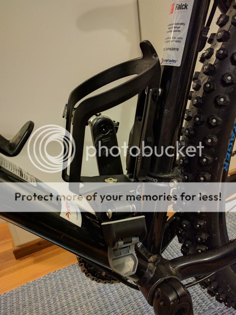

    Wanted to see if I could shed some weight off the stuff that I carry with me. After a bit of tinkering a velcro strap turned into an awesome strap kind of thing and I was able to fit all the necessary stuff I need to carry with me in it, plus a few zipties. The tool bottle thingy turned out to weigh 100 grams, far more than I expected Made an excel chart of the weighs and with no money spent the weight of the bike had gone down by 95 grams. That can be made to 145 grams if I take off the other bottle cage since I don't really need it in winter. It's a win-win in the end I'd say
    (It looks crude, I know, but it's not gonna stay like this for long).
    If my calculations are correct a lighter pump, tube and a Topeak mtb bottle cage thingy would help me to lose over 200 grams from my original setup and the roadie version would make that 320 grams! I'm just torn between whether to take the mtb version with a chaintool or get the roadie version and get a small seperate chain device later on. Any suggestions?
    P.S A weight weenie bug has definitely bitten me, I would have never imagined I'd start counting grams like this. It's actually pretty fun!
    Current: 14.1 kg
    -allu

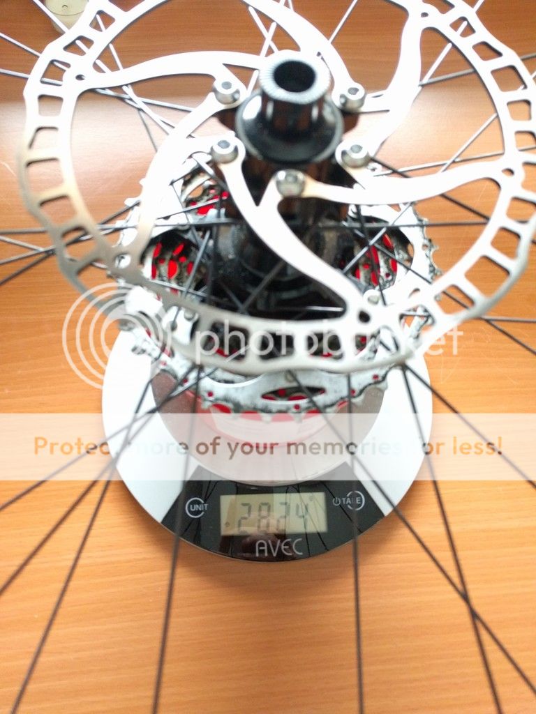

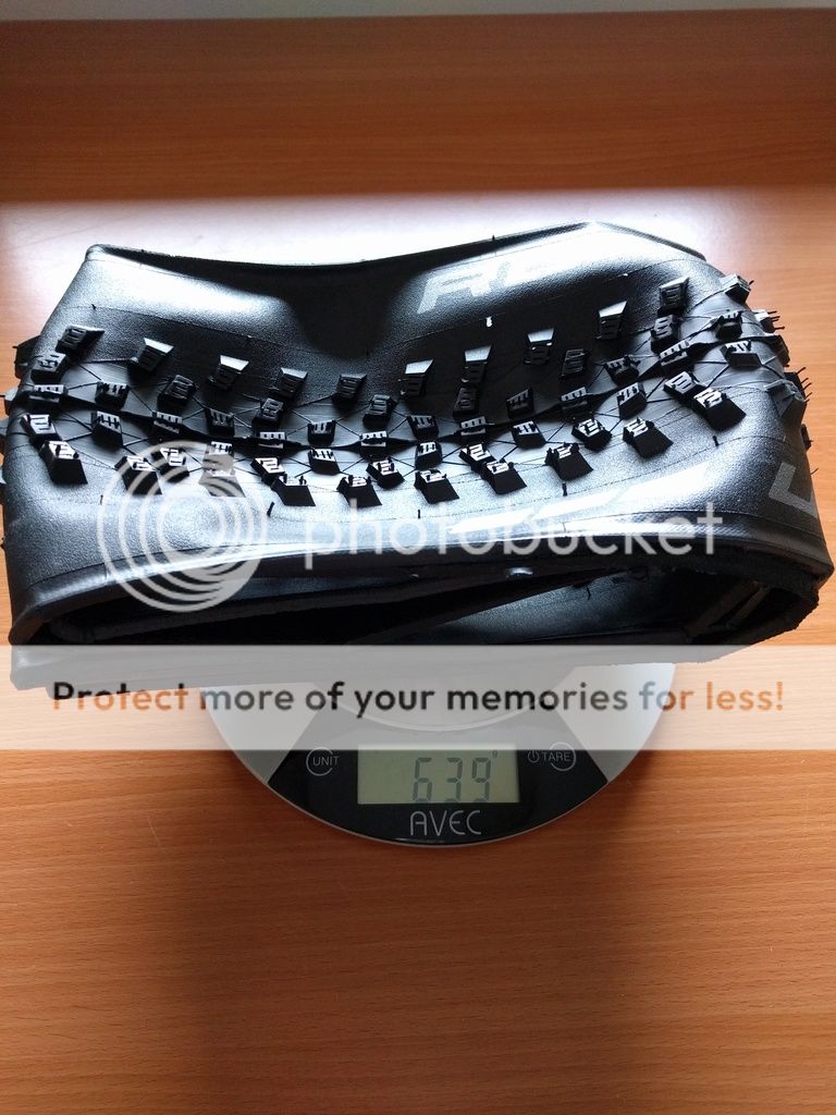

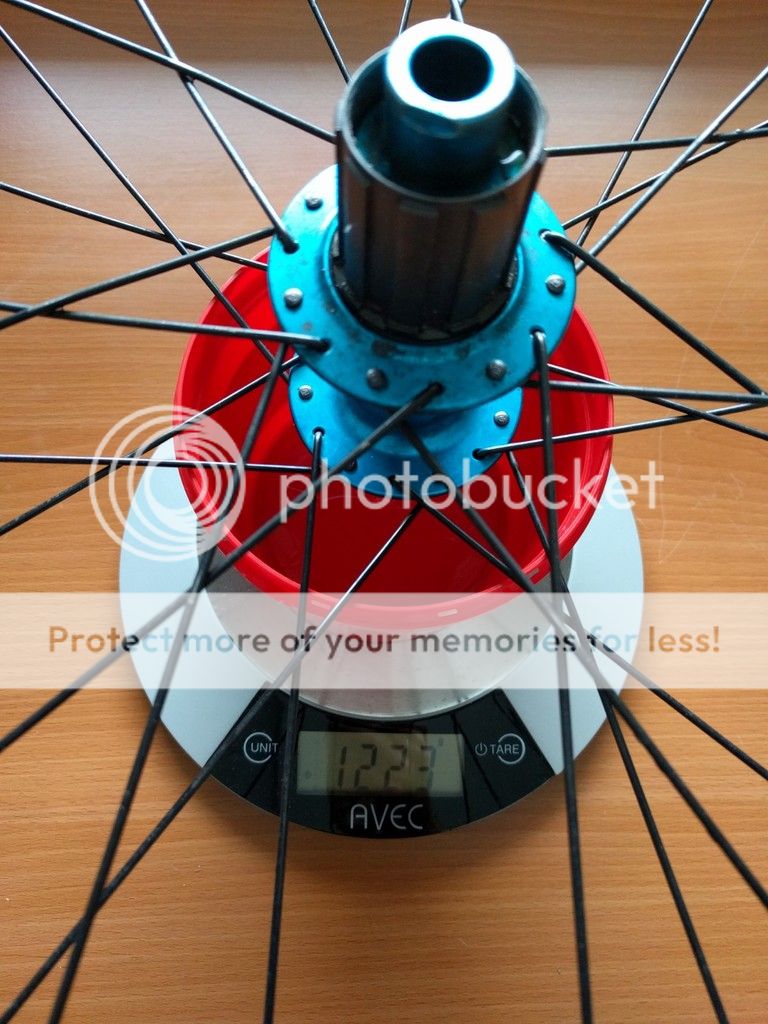

    Thanks for the info! I'll be looking into getting lighter rotors after upgrading the wheels, since most centerlock discs seem to be pretty hefty.. The lighter ones are particularly pricey too

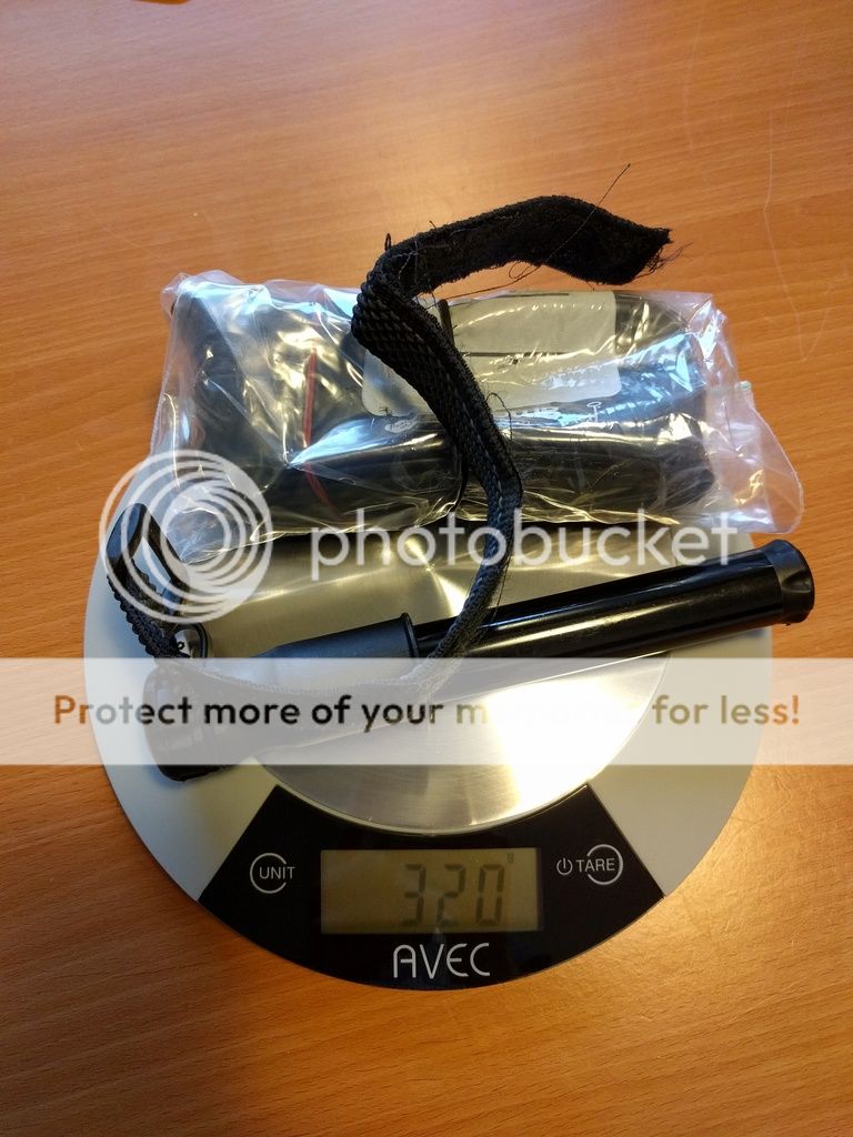

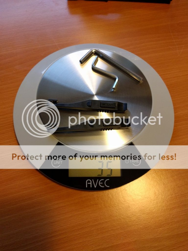

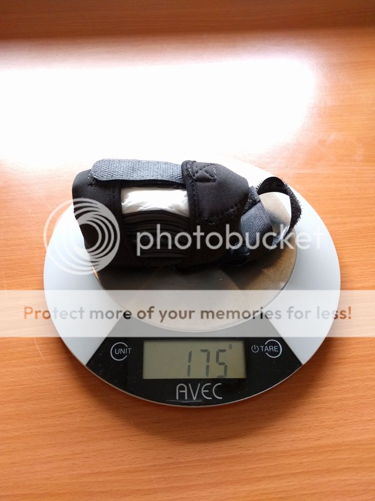

    Finally got myself a proper scale so here's some scale shots. Focused on tools and spares this time:

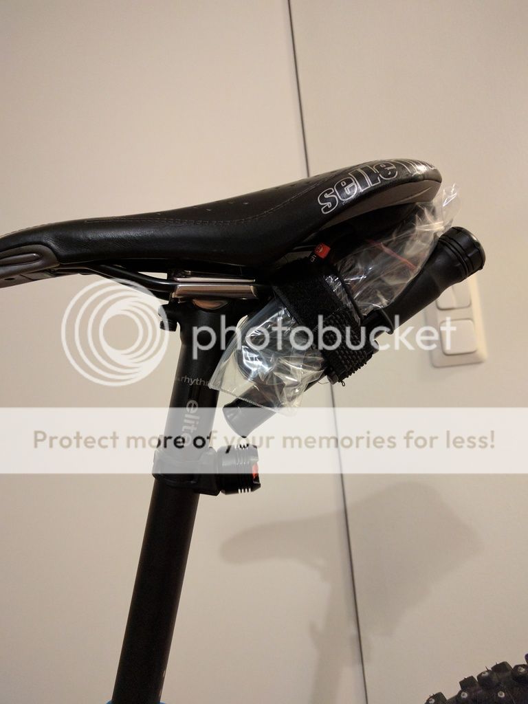

    DIY even more Awesome Race Strap (tube 225g, pump 82g, strap 12g) = 320 g. Lots of weight to lose here since the tube could be 115g and pump 58g which would net me a nice -134g weight loss.

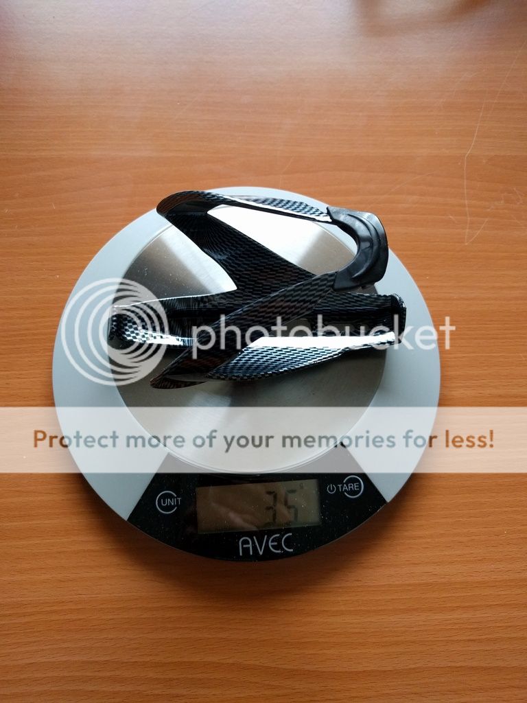

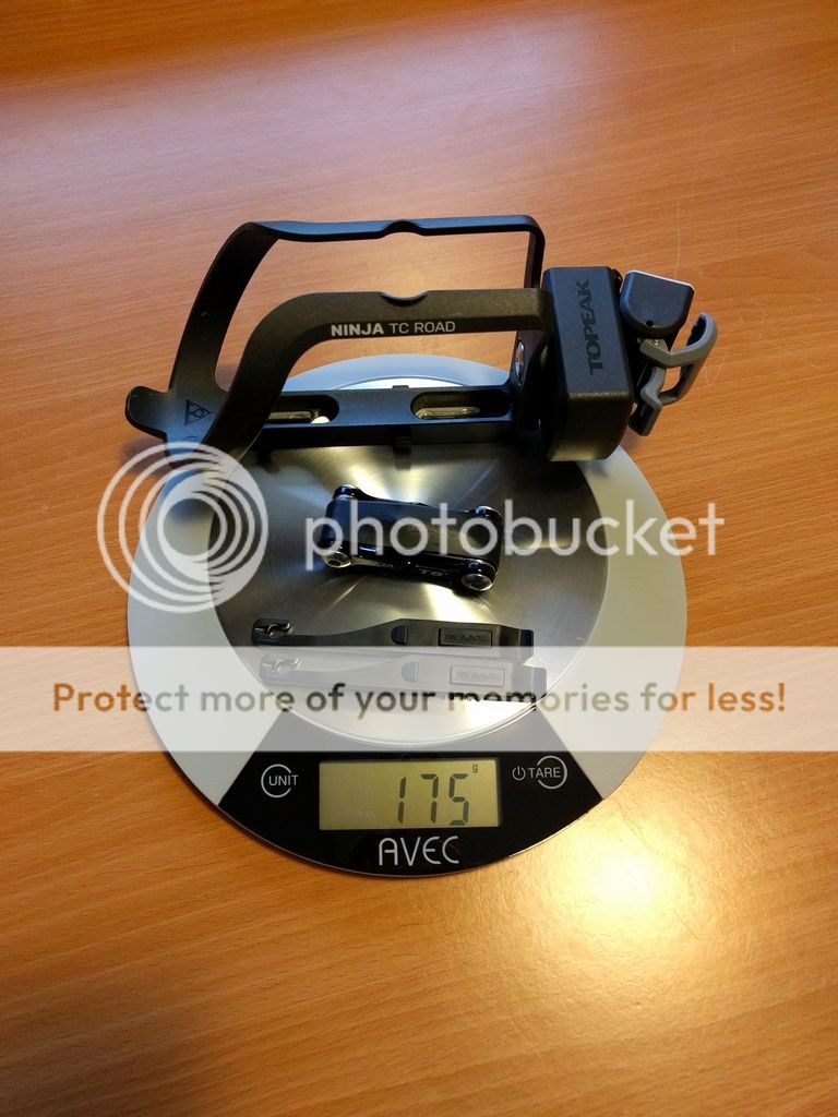

    Topeak ninja roadie toolkit bottlecage (cage 90g, tool 74g, levers 11g) = 175 g. Lots of weight to lose here too especially after I realized the tool has so many unnecessary bits on it. I checked and realized I'd survive with only 4 and 5 mm allen keys since apart from pedals and chainring bolts (and possibly a few bolts somewhere I didn't look at) my bike uses those two heads only. So this could be possible for tools:
    +26 gram for a Carbon cage that I ordered. I guess I'm going to ditch the Topeak ninja after all. It's handy and convenient, but feels unnecessarily heavy. Though only if I can figure out another way to attach the tools to my bike, any suggestions? Two allen keys shouldn't be that hard to attach
    -allu

    Re the centrelock wheels, if you opt for an IS6 (6-bolt) design like some of the ones mentioned, you'd need an adapter. This adds enough weight that you lose any benefit from that lighter rotor. Seems best to stick to a centrelock-type rotor, avoiding the adapter.
    Was wondering if you'd want a chain tool in the mix. Or at least carry a couple of quick links that can bail you out in some cases. (?)

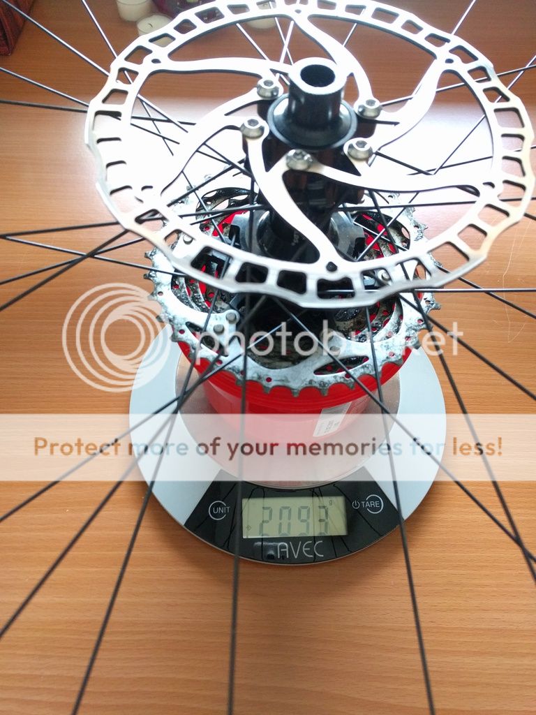

    That wheelset is heavy as an anchor. Replacing it will save significant weight, rotational weight at that. I have a Superfly 6 with the same wheelset and after I removed the 200 gram shimano rotors, and tires, and skewers, mine came in at a porky 2,098 grams. you could get something at least 400 grams lighter than that for a reasonable price.....500 less if you spend some cash. I'm running Mavic Crossmax SLRs at 1600 grams and when I installed them the bike felt like a friggen' rocket, in addition to making it a full pound lighter. You are doing a great job on this build.....that is a great bike. Keep up the great work and keep us posted!
    Interesting, good to know! I always thought the wheelset was around 1800 grams, but geez I was wrong lol. In that case I'll definitely be looking into getting a lighter wheelset in a few months after saving up some money. Thanks for letting me know!

    Seriously speaking, it's not that hard to lose significant weight on Superfly 8 even on budget. From personal experience I can tell the 1 x drivetrain is the best upgrade you can do if it just works for your type of riding. You'd probably lose closer to 500 grams from 3x setup without sacrificing much in terms of usability. If you still haven't gone tubeless, do it! That 100 grams or so per tire means much more than half a kilogram off the frame.
    Another great upgrade is a carbon bar and possibly a lighter stem (the original stem was something like 150-160 grams, so pretty bulky). Not too pricey if you buy them second hand for example. Again you could lose 100-200 grams depending on how light you go. In your case you could lose 100 grams or more with lighter grips. A few hundred grams off the cockpit and the bike wheelies much more easily! A Chinese carbon saddle is also dirt cheap and easily drops the weight by 100-200 grams depending on the original saddle. After these upgrades you might have lost a kilo already and if you bought the more expensive parts second hand and sold the original parts for some money later on, we might be talking about less than 50€ spent in total. So not that expensive after all
    Sometimes you don't even need to spend money at all. Just take out all the tools and spares you carry with you and pick only the absolutely necessary, but don't go overboard with it. Something like a Topeak ninja or Specialized SWAT bottlecages with integrated storage for a multitool (and tire levers) is often the most convenient and light solution for your tools. Sure you can always go lighter than that, heck you could just tape an allen key or two to your frame, but is it convenient to use? Thought so.
    Also new parts arrived. Lost a whopping 10 grams of the bottle cage These are actually pretty good for 1,5€, mine did hold a large water bottle in place even when the bike went upside down! Though the fake carbon paintjob is absolutely terrible, why didn't I just take them black
    New stem (-11 grams): 13.22 kg
    Changed pedals (+83 grams): 13.19 kg
    Current: 13.03 kg, lost 1150 grams

    Finally went below 13 kg too, a milestone achieved I guess?
    I think I have run out of cheap upgrades to do on the bike now... Besides the tires and something like brake rotors and seatpost which are not very cost effective. Next up might be the wheels if I can find a good pair second hand or good deals appear on stores.
    New grisps (-78 grams): 12.94 kg
    Current: 12.94 kg, lost 1230 grams

    Quote Originally Posted by KPduty View Post
    While working on the brakes put the wheels on a scale and man those wheels are heavy
    Front wheel roughly (2605 g - tire 1170 g - rotor 175 g - sealant ~ 100 g) = 1160 grams for the wheel including rim strip and valve.
    Rear wheel in similar fashion (3059 g - tire 1170 g - rotor 150 g - cassette 340 g - sealant ~ 100 g) = 1299 grams for the wheel incl. rim strip and valve.
    Did I forget to take something into account or can these wheel seriously be this heavy? Like nearly 2.5 kg for a wheelset? Some of it might be sealant, but even if there was 150 grams of sealant in each tire the weight would still be 2.4 kg If this is true then losing significant weight off the wheels won't be even that expensive, heck DT swiss x 1900 Spline wheelset would come in at 1875 grams which is heavy but still half a kilogram lighter than this. Is this one of those cases where a manufacturer specs the bike with nice components and fork and to keep the price down ships it with a really heavy and cheap wheelset?

    Got a second hand Reynold's 29er al -wheelset. They come in at 1720 grams for a wheelset so not too bad for less than 200€. A mistake that I made is I never asked the seller whether the rim strip was tubeless ready or not, turned out it wasn't... Was kind of difficult trying to set them up tubeless when air just went straight through the rim strip, oops Oh well, I was too exhausted to figure out some ghetto tubeless rim strip hack so just set them up with tubes after fighting with the tire for hours. I won't be running the winter tires for too long anyway, so I can survive with tubes for now.
    Original front wheel:
    Front disc:
    New front wheel:
    Ashima Ai-rotor:
    We shall see if rear wheel co-operates better... More of that tomorrow.

    The rear wheel ended up being far easier to change and got it all set up with tubes again. The weight turned out to be:
    Original Bontrager rear wheel was hefty 1223 grams and the 160 mm SLX rotor was 138 grams.
    So the original wheelset weighs 2221 grams and the Reynold's one is 1720 grams. 501 grams lighter for a very reasonable price. Take into account the rotors and the difference goes up to 608 grams. This difference would have been more like 800+ grams if I had ran the tires tubeless like I did on the Bontrager wheels. Alongside with the weight there's an enormous difference in friction, or lack of thereof. The old wheels even with completely functional bearings (no play or roughness in them) wouldn't spin very long whereas these spin to a point that I get tired of watching. I'd estimate at least 3-4 times longer, so there's some watts saved for sure Especially the freehub seems to be much better and smoother on these, albeit louder.
    I also decided to ditch the spare tube I have carried around. These tyres are really heavy duty and got high puncture resistance rating although accidents happen. The main reason is because the tires are so ridiculously tight to put on the tires that there's no way I'm gonna be doing some trail-side tire fixes. Besides, I never ride that far from home in winter that I couldn't hike back if needed. Wouldn't accept this for Summer tires though, just to avoid those +10 km hikes back home after a puncture. I guess these tires are just made with tighter tolerances, never had this kind of problems with other tires even from Schwalbe. With that ditched the whole weight of the bike drops down to 12.35 kg, 1815 grams lost
    PS. Many people laugh at weight weenies for losing weight of the bike when that weight could come off their waist for free. Well, Last week I went on a scale myself for the first time since last Spring and turned out I'm 9 kg or 20 pounds lighter than I used to be, long bike rides have done their job

    Just a quick update, not much has happened on the bike recently apart from a new saddle. Another Chinese knock off carbon saddle, feels comfy so far but yet to test it properly. Also, 10 grams lighter than the earlier carbon saddle.
    Replaced the neoprene chainstay protector and old tape that was underneath it with new tape, lost another whopping 10 grams
    Current: 12.33 kg, lost 1835 grams

    Changed the rear wheel from ISP to Racing Ralph snakeskin pacestar. Setting them up tubeless was super easy and no problem getting the tire seated with a floor pump. Even once it was nice to work with bike tires lol.
    The Ice Spiker Pro was very hefty at 1 245 grams, plus a heavy tube weighing 225 grams. The RaRa I put on is 648 grams, plus 70-80 ml of sealant. So we ended up losing 731 grams of rotational mass, more to come once I get the front wheel changed. Still got to wait for the rest of the snow to melt before doing it though.
    Also, after one ride one the new saddle I can already tell it's miles better fit for me. So much more comfortable as it's narrower, the earlier saddle was slightly too wide for me. Also it flexes far more than the earlier one to a point that I was scared of it breaking down in use. I tried to stay seated over every bump I encountered to stress it as much as possible, but it didn't give up, yet at least. Paired with new better quality and especially tighter fitting bib-shorts that I got, mountain biking has never been this comfortable
    Current: 11.59 kg, lost 2 566 grams
    -allu

    To avoid a hike back home put the tube and a tire lever back underneath the seat, gained 149 grams. Wanted to play with the tools again, ending up with something like this:
    Just a single 4 and 5 mm hex key with a piece of an old inner tube stretched over it for protection. Strapped to seatpost using another piece of inner tube. Looks pretty makeshift, but works well enough and is light for sure. Compared to the earlier set up with Topeak Ninja lost a nice 161 grams with this. Granted, lost the second bottle cage on the process, but most of the time I wasn't using it anyway.
    We'll see if I can get the bike under 10 kg this summer with increased budget. Under 11 kg is easy, but the next kilo gets far more expensive...
    Current: 11.58 kg, lost 2 576 grams
    -allu

    Aug 2016
    99
    Not much has happened on the bike besides a new front tire showed up and twiddling with the tools, like always. So Schwalbe Rocket Ron 29" x 2.25 Snakeskin pacestar came in at 639 grams:
    A bit heavier than advertised but I can live with that. Once installed the front tire was 78 grams lighter. A Syncros 180 speed road saddle bag turned out to be a pretty clever way of carrying all the absolutely necessary, apart from the chain tool. Currently it contains a 4 and 5 mm hex key, the tube, a pair of single use rubber gloves in a ziplock bag and a tire lever:
    -allu
