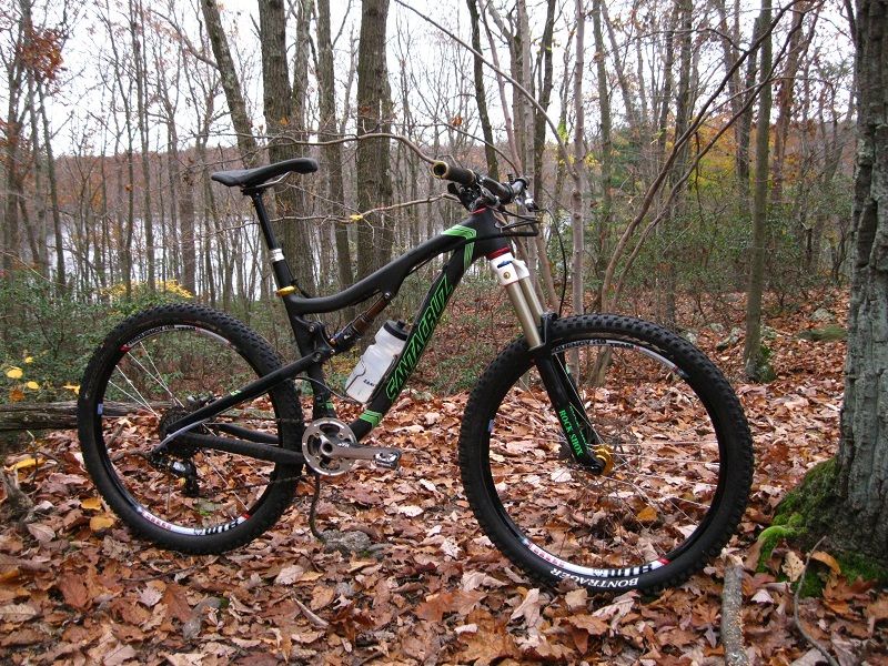

    On mine, the only mods are ESI grips, Thompsone Masterpiece 350mm post, WTB Ti saddle, Q Superlight tubes. The stock bar and stem are already quite light. Works and feels very nice.
    Like this?
    Masterpiece 350mm post and WBT Ti Silverado
    ESI Grips, very nice, very light.
    Specialized Stumpjumper Pro

    I have large 2011 Trance X1 with a 1x10 setup weighting 25.2lbs with the reverb. Once I replace the SLX cassette with XG1080 it will drop below 25. With a TRC frame the bike would weigh less than 24. Not bad for a strong and not super expensive build.
    Wow trek551 that's an impressive weight for a trance.. Very nice!

    Thanks.
