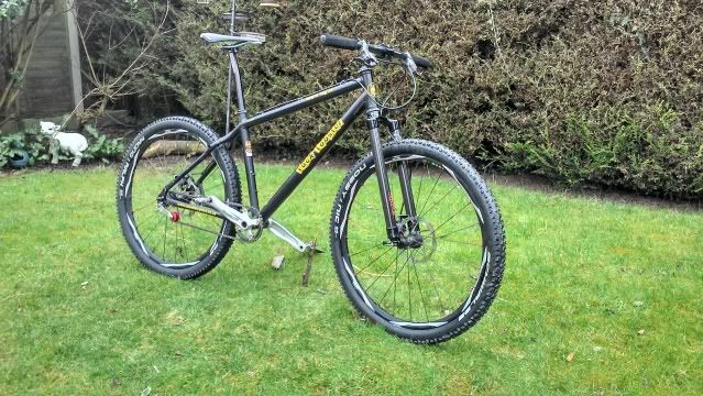

    I have both the Exotic UD and 3k carbon rigid forks. The 3k is lighter (although 80mm whereas the US is 100mm) and looks better IMO.
    UD:
    3k:

    Reputation: roaringboy's Avatar
    194
    Re: Need help picking light rigid fork from list of "budget" ideas
    Quote Originally Posted by vikingshelmut View Post
    Do you by chance have a closer picture of the carbon legs on the UD version? My Syncros bar is UD, and I'm wondering if the forks look similar.
    I don't but I'll have a go when I get home from work in a bit
    194
    Thanks. I had never seen anything that was "UD" before, so when I got my carbon bar the look of it kind of surprised me (no weave, visible "layers"). I'm curious if the UD Exotic fork looks the same.
    Here you go:
    It's hard to capture the true effect in a photo. They look best in sunlight when they become a grey almost holographic look. Very cool. Sometimes just look black in low light.
    These are the 3k as a comparison:
    Sent from my XT890 using Tapatalk 2
