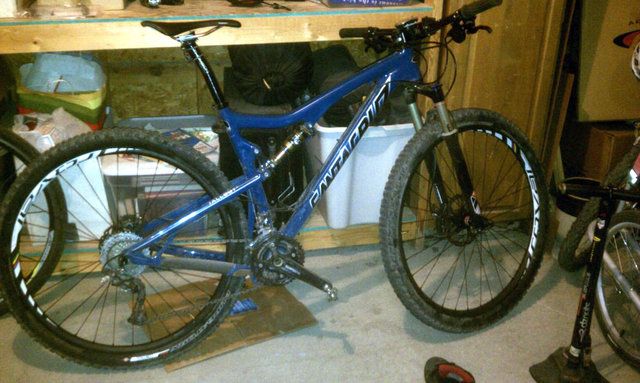

    My Santa Cruz Tallboy Carbon is not as light as I'd hoped
    Hello. I just got myself a 2012 Santa Cruz Tallboy carbon (size large) on year end closeout. I LOVE IT!! This is my first carbon frame bike and while I love the feel of the ride, I have to say I was expecting it to be a bit lighter. I am hoping for a quick once-over by the more weight-focused crowd and some suggestions on upgrades over time. On the scale it came in at 28.45 lbs. The build is pretty much Shimano XT all around. I was/am hoping for a weight in the mid 20's. Below are the specs from the SC website, but they are different from the 2012 build. My changes are in blue.
    Santa Cruz Bicycles TALLBOY CARBON
    REAR DER: Shimano XT
    FRONT DER: Shimano M780 or M781 (XT) 10 spdd
    SHIFTERS: Shimano M670 (SLX) 10spd
    CRANKSET: Shimano M552 24/32/42 10spd
    BOTTOM BRACKET:
    CASSETTE: Shimano HG 81, 11-36 (SLX) 10spd
    CHAIN: Shimano HG 74 10spd
    BRAKES: Avid Elixir 5's Swapped out for Shimano XT with 180 front, 160 rear
    BARS: Truvativ Stylo T20, being swapped out for a Truvativ T40
    STEM: Truvativ 70mm or 90mm
    GRIPS: Lizard Skin "494"
    HEADSET: Cane Creek 10
    SEAT POST: Some type of Easton, swapped it out for a Thomson Masterpiece setback 30.9x375mm
    SADDLE: WTB Volt Race swapped out for my Specialized Phenom
    WHEELS: WTB i19 TCS rims laced to Shimano M758 front hub (XT) and M678 (SLX) or M 756 (XT) rear hub w/ DT 14 gauge spokes, brass nipples. I think my front hub is a non-series Shimano, it definitely doesn't say "XT" like the rear hub does.
    I use Crank Brothers eggbeater S pedals.
    The rear shock is actually the 2013 Fox CTD, the fork is a Rock Shox Reba RL.
    I swapped out the OEM Crossmark tires with tubes for Specialized Purgatory 2.3's mounted tubeless with a lot of sealant. Since this was the first time mounting the wheelset tubeless I thought I should go heavy on the sealant because I expected some weepage, but I have not had any. I know that the tires and sealant probably added more weight than I took off. My lustful future upgrade are a wheelset with carbon rims. Cassette and chain will be upgraded as they wear.
    So what are the glaringly "heavy" components on this bike? Thanks.

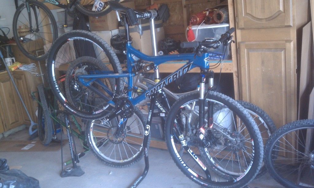

    Upgrade
    New wheelset, Roval Control SL 29
    Same Purgatory tires tubeless
    26.45 lbs
    The Rovals were 1470 g combined (783/687 g) out of the box. Test ride to the convenience store and back and I could already feel the fast acceleration and stiffness. I can't wait to get them out on the trail.
    While I had things apart I threw them on the scale.
    Some interesting stats:
    Ice tech 180 mm rotor w/ 6 screws = 148 g
    Ice tech 160 mm rotor w/ 6 screws = 127 g
    Roval front QR 9 mm = 56 g
    Roval rear QR = 56 g
    Rock Shox 15 mm thru axle = 74 g
    Shimano XT rear QR = 64 g
    OEM cassette = 364 g Shimano HG 81, 11-36 (SLX) 10spd
    Stock front wheel = 894 g WTB i19 TCS rims laced to Shimano M678 (SLX) w/ DT 14 gauge spokes, brass nipples
    Stock rear wheel = 1120 g WTB i19 TCS rims M 756 (XT) rear hub

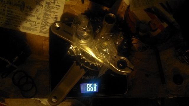

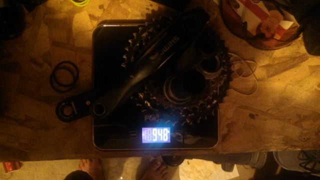

    Recent upgrades
    XT cranks (stayed with a triple), XT cassette, XT chain, Purgatory front tire, Ground Control rear (temporarily with tube until the shop gets the right spokes in)
    25.9 lbs
    Some component weights:
    New XT M780 crankset 868 g
    OEM M552 crankset 948 g
    XT cassette 342 g
    I forgot the weight of the SLX cassette, I think it was in the 360 g range.
    Edit: 25.7 lbs with the rear tire tubeless.
