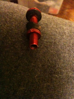

    Here they are!
    Already installed on ZTR Alpine rims, 6 gram
    I had to bend the edge of the valve where it sits on the rim for a better siting and conformance...
    I hope they dont break!
    Reputation: sfer1's Avatar
    547
    I wouldn't use bent valves to save mere 7.8g/pair.

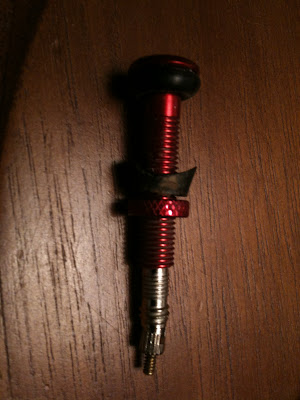

    Reputation: thatdrewguy's Avatar
    411
    Quote Originally Posted by sergio_pt View Post
    I'm looking at the package that was posted and did you use that block of rubber that is above the O-ring and below the nut? Isn't that suppose to be on the outside under the nut? I don't see it in your picture.
    Maromero
    Reputation: doccoraje's Avatar
    1,154
    I just received mine today also. 6.8 gr without caps.
    Sergio, some questions, why did you have to bend them, wasn't the rubber donut enough to conform to the rim shape? Also, any reason for not using the plastic washer?
    Reputation: 2002maniac's Avatar
    Nov 2008
    333
    No problems to report using the AC valves with stans arch. They sealed up just fine with a slightly squished o-ring. no bending required.
