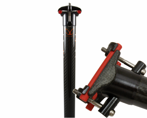

    carboncycles.cc have nice carbon seatposts in 31.6 dia. They have a great lower carbon clamp and the weight would be similar:
    For $70 they look like good value for money. I've got one on order for the wife's bike.

    I got a CC 27.2 350 mm, heavier than the New Ultimate I use, anyway I used only the lower craddle to give more support to the carbon rails of my KomVor. I don't remember how much the plastic rods weighed.
    Attached Thumbnails Attached Thumbnails Climax Carbon Seat Post-Any thoughts?-seatpost-exotic.jpg

    I've got a KCNC in 30.9mm x 350mm and being so light (148g) there is a fair amount of flex. If you lean across the bike and push with your chest on the saddle you can see the post bend (probably around 5mm). How much flex will depend on how much seatpost you have showing. An equivalent weight carbon post may have less flex. Thin-wall aluminium can be pretty flexy.
    Carboncycles seat cradle diameter
    Saw the seat cradle on the Carboncycles seapost. Can anyone tell me what diameter the cradle is? I want to fit this to my Colnago seatpost but the diameter has to be the same. Would prefer the latest Colnago clamp but I have tried everywhere to get one but all dealers say you have to buy the whole seatpost!!
    Also for those who have fitted this Carboncycles cradle/seatpost have there been any problems? I am basically looking for a tough part, not some poorly made, flimsy part that will break in a few months.
