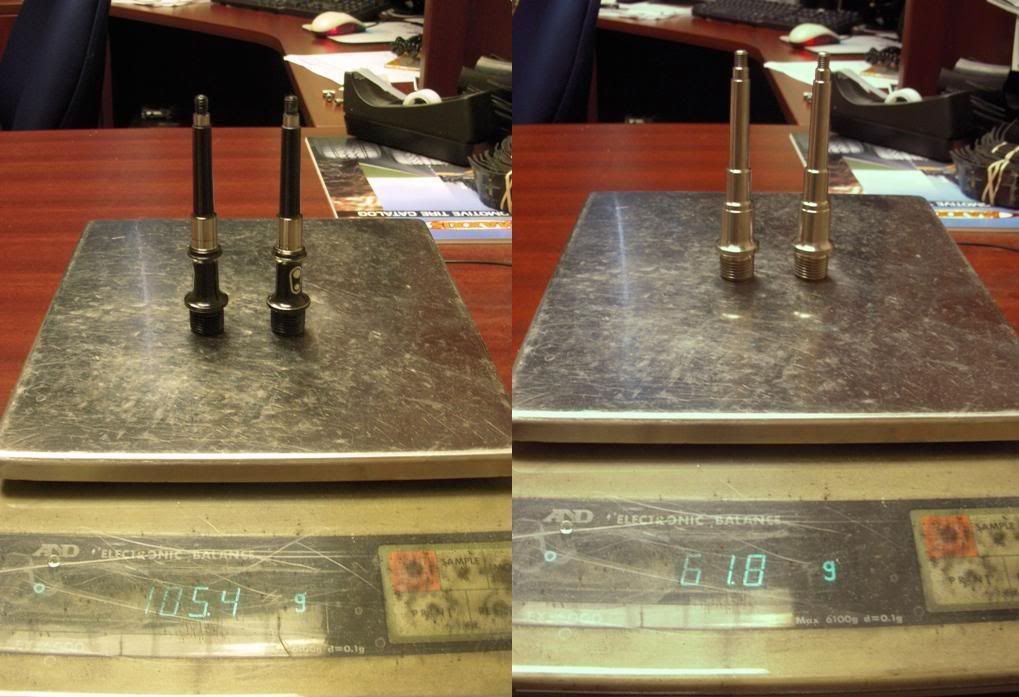

    bholwell
    This photo shows the old style cromoly spindles on the left, and the short Ward Ind. Ti spindles on the right.
    The new spindles should be around the same weight, and Ti is usually about 2/3 the weight of steel.
    BTW, my 2 Ti with short Ti spindle eggbeaters are 189g. I train on Eggbeater 3's (289g) and race on the "3 Ti's"
