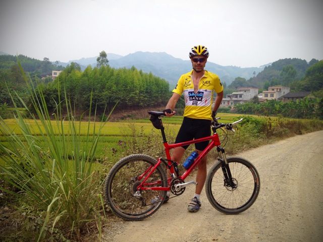

    Fellow WWs, help me blow 2 grand on upgrading my Top Fuel. All options considered, except tires. I've already been exporing options there to suit my needs.
    Here are my specific needs:
    * I do use the 22x34 gear surprisingly often, so I need something that low (0.67 gear ratio).
    * I need at least a 3.65 gear ratio on the high end.
    * I will change to 180mm cranks. I'm 6'3" (1.9m) tall and love the 180's on my road bikes.
    * pedals must be egg beater compatible since I have them on all my other bikes.
    * wheel changes must have weight added to they are tubless ready.
    * any frame change must be dual suspension.
    * me + gear is about 85kg.
    * $2,000ish budget
    The bike and me
    Build less tires. Items in blue color are actual measured weights. Everything else is a guess. Total is direct measurement and, yes, it came out to exactly 10000g.

    2K ? on upgrading that bike, are you serious Dozer?
    BUY A NEW BIKE MATE, imo it is pure madness spending 2k to upgrade that Trek.
    cheers, and sorry if i sound harsh, but really.......

    You don't have any tyres in your list.
    Assuming they're not included in the 1635g for the wheelset, your best place to save weight would be lighter wheels and tyres. A set of Stans Alpines on DT hubs with some Schwalbe tyres would save best part of a lb I reckon.
    I have a set of Alpines on American Classic hubs and they're about 1300g - the DT hubs are lighter I think.
    Are those forks really 1466g? That's fairly light already but you could opt for some Magura Durin Sl's and save 100g or so.
    Edit:- just seen that you don't want to change your tyres - any reason?
