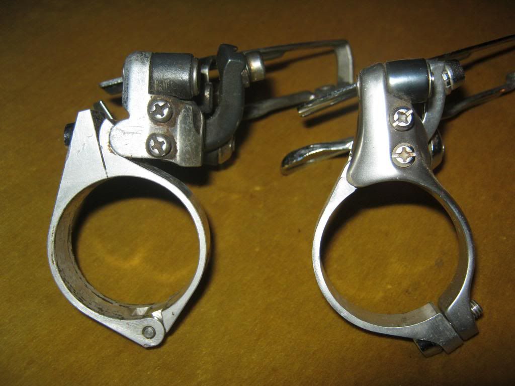

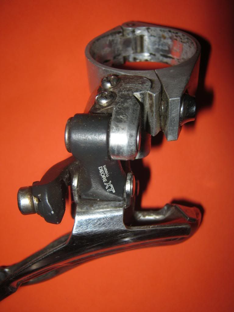

    I think I have an XTR front derailleur that has a custom clamp for a Manitou somewhere in my pile of stuff...

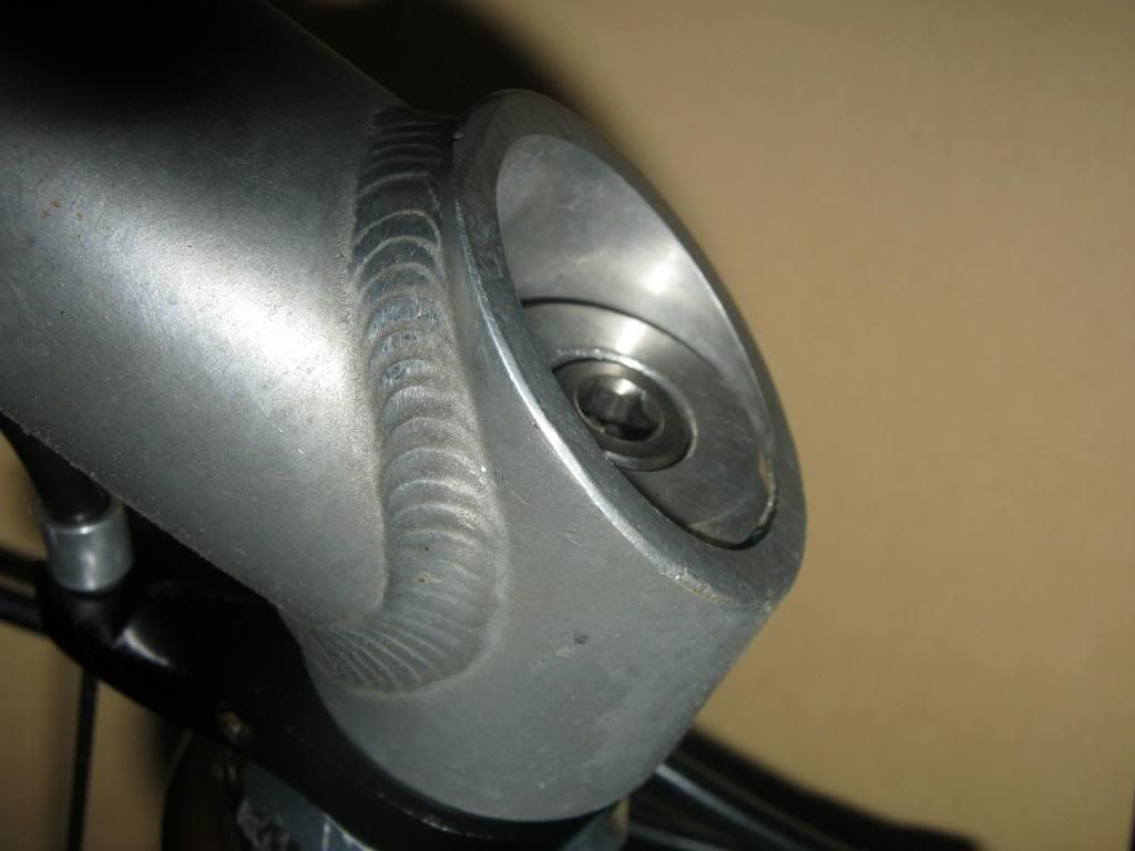

    So the fork on one of my cross bikes was to short to fit the cable hanger, so what to do...!?!?
    Well mount a rollamagic to the stem.
    I use one of the frame cable stop for V-brakes that fit the stem almost perfectly, also made a small stop so the rollamagic will not rotate when braking.
    It has works perfectly for the last 4 years with out a single issue.

    At the risk of derailling the "which way should XTR brake pads face?" thread.....
    Some Manitou modded derailleurs: (XT and XTR)
    Steve

    Never quoted myself before, but curious.....I've seen a few of the modded XTR' s like mine and fatchanceti's, but my XT version has a different clamp arrangement...anyone know if they did any other variations?
    Steve

    The XT one looks like a standard braze on derailleur with a separate clamp. I don't remember them making an XT for the braze-on mount though.

    Quote Originally Posted by muddybuddy View Post
    Better pic...def XT...maybe the braze on mount was a mod too?
    Steve
