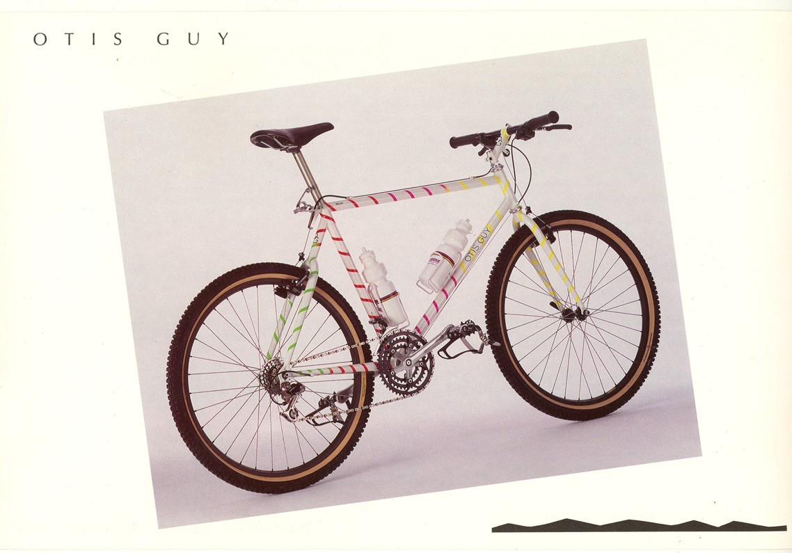

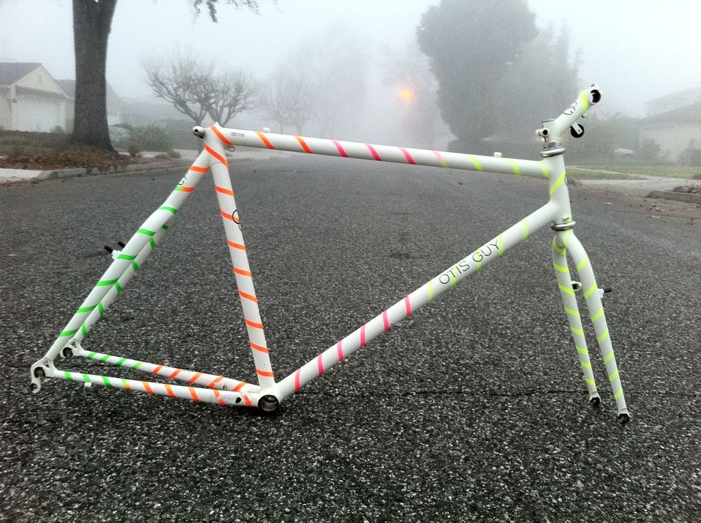

    Too good not to share. The Art Of The Mountain Bike: Otis Guy
    I'm an Otis Guy fan. Love his work and the way my 85 OG rides and I'm always on the look out for another one. Needless to say, this new addition is more than a little exciting for me. I'm eternally grateful and in SW's debt for making it happen and allowing me the opportunity to bring this gem back to light.
    I'm pretty much starting from scratch collecting parts (which shouldn't be too difficult), but it will truly be an enjoyable journey getting it back to 'show spec'.

    I wouldn't leave that in the middle of the road.
    Beautiful frame!

    Someone ran over it shortly after the pictures were taken.

    what a find! the neon rasta candy-cane paint is awesome. and the stem is really really cool too.
    I look forward to seeing this one completed!

    1989-1990. Braunstein Quay.
    CK has the info here:
    http://sonic.net/~ckelly/Seekay/artofmountainbike.htm

    It's funny to see the hite rite on backwards compared to how we normally see it on the Breezer.

    Major score. That thing neeeds a full stx-rc kit.

    Is that TT actually 25 1/2"? It looks long but..........

    It says Suntour...I was thinking maybe XCM Nice pick-up Eric

    Compared to some of the other players in the show, pretty agressive geometry. 73/73 head/seat, 16 3/8 chainstay, 25 1/2 top tube....
    I like it......

    Cool frame! Now you need a neon candy cane striped lycra skin suit to match
    I thought you lived in CA,that looks like Spring in the Northeast, grey, overcast, foggy. You mean the sun doesn't always shine out there????

    Really like the interesting tri-color paint scheme.
    Do you know why he made the frame with such a steep head angle (aside from the obvious "built for use anywhere" statement)? A very east coast head angle!

    are there some east coast mountain bikes that use a 73 head angle?

    Thanks for all the kind words everyone!
    I'm pretty excited about the project. I'll be trying to get it to as close to the show spec as possible. I think it'd be sac-relig otherwise.

    Yeah, no doubt. That thing looks nearly new. Even the dayglo colors still look really bright. It's amazing what some of you all are able to drum up.

    Not too much of a back story to tell. I talked to Otis a bit about the bike.
    He said it was built with steeper ht angle and shorter rake fork and was ultimately sold through (he thinks) Palo Alto bikes 'as new'.
    I'm assuming the person that bought the bike was responsible for the trail ware.
    It may have been sold a second time since the owner I got it from (again, thanks entirely to another regular VRC'er here for 'brokering' the deal) had it sitting in the state you see it above for....15+ years I suppose. Tucked away in a box, languishing in obscurity.
    The build goal looks like a first year XC Pro spec (new for 1990)
    Serial number on the bike is (I think...the paint is pretty thick):
    107
    OG

    Chain stays look pretty beefy...almost like fork legs.

    Ya, the seat stays look a lot like the fork.
    Might not be done till K'Ville 2013.
    Most definitely won't be repainted!

    It was a fun project. Took me long enough, but I'm happy to be (mostly) done. There are a few details I need to correct, but it was at a point that there was no reason not to finish the bike because of it.
    I need a set of black Suntour chain rings and a set of Suntour wheel quick releases (with the black rubberized lever that comes with the XC Pro hubs).
    I also took a few creative liberties since it was difficult to determine the exact part used from the pics.
    Otis said they used 'the best Suntour available at the time'...which was as much detail as he could remember. The pictures look like X-Press....which was so awful when it came in (they were even NOS), I refused to use them.
    There are also two photos of this bike. The card photo shows the bike with a black wheelset. To me it looks like XT, HG cassette. The only black Suntour were XC9000's, which would fall out of line with the XC Pro build as well.
    The other photo with Otis in the picture, the wheelset is silver...which is what I went with since XC Pro only cam in silver (that I know of).
    Definitely some oddities about this bike. Yes the top tube is 25" (and change). Short stem, less fork rake, 73*/73* angles. Feels...normal, but not. The other strange thing is the 130mm spacing out back...on a bike from 89/90, that's also unusual. Made finding the right hub more difficult than I'd figured. Hollister built the wheelset on MA40 rims. It's fully rad. I even had to go to a coin shop to get the Indian Head nickel.
