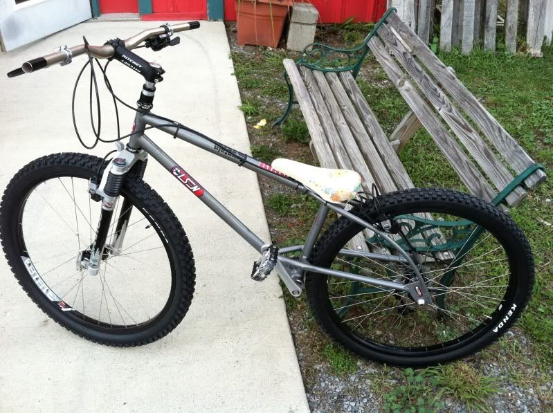

    Apparently this is a good time per the creator of #12. I have to say the floral print is growing on me quickly. It looks sssssuper fantaaaaastic! Considering he worked this out from across the country made it even more funny.
    The last time I remember John having a good time at my expense I ended up rolling in nettles after an attempt to pass him on a climb. This is much more pleasant, I think he is getting soft in his advanced years.

    Is Mendon Cycle Smith the coolest dealer in the Universe, or what? He was able to sense that Josh needed a saddle for Full Leg Extension, and take it upon himself to correct Josh's obvious problem, even going so far as to suggest a styling direction that will clearly take the former Devildog in a whole new direction in his life. Josh, you could even secure the saddle to the bike by tying it on with your extra brake hose.
    I HAD hoped that he would find one with tassells...
    gobsmacked Moderator
    8,748
    Interesting cabling on that flower seated bike.
    Yes, Mendon is the coolest cat in the house. I'm his number one fan.

    Quote Originally Posted by StrangeBike13 View Post
    I figured the tassles would get stuck in the spokes, but thought that the subtle pearlescent nature of the fine grade Naugahyde would work in our favor.

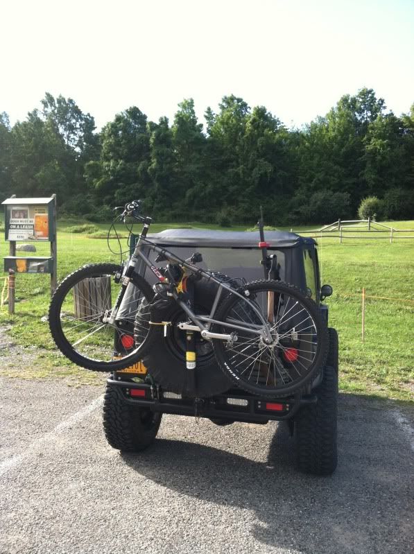

    So this morning was the morning I have been dreaming of for over 20yrs. The day I went for a ride on an infamous Strange Bike that has miraculously ended up in my hands.
    Started off in the skills area of Dryer park to get a feel for the geometry, need lots of practice with my balance to be able to ride atop down trees again. On to the ride... Just 25' into the trail and the chain popped off the front chain ring. I did a quick spin then flew over the bars landing on the ground in front of the bike after a non intentional ninja roll, I was left laying there looking back at the bike wondering just what had happened. Maybe to many links in the chain, seems a bit floppy. After getting past the drivetrain issues I continued my climb to the upper field and around the Ziggy trail. Rode down Jakes trail and loved easing my way off the drops and winding through the tight tree sections. After making it to bottom of the trail I wanted to try climbing West World. Amazing how well the bike does, after many stops due to the lack of fitness I finally made it back to the top to Ziggy. I continued to work my way around the hill in a counter clockwise rotation going up and down making it up the Ladder, the Escalator, the SSW, then Moonvalley. The down hill sections were fun, but it felt good to be able to climb every thing today. Also had to stop a few times and play around on the more technical tree and root sections along the way. I was on the trail for 2.5 hrs only riding 4.76 miles in 1 hr the rest of the time was spent catching my breath from the climbs and a long visit with some curious mtn bikers as to why my bike was missing the seat. "It save's weight, which I need due to being so out of shape"!
    So I thought this would be an inexpensive build because I was going to rob the parts from my Schwin Paramount 90 series from my high school days. Started out the steerer tube is 1 1/8" but really short, not a 1". Then the wheels, thought maybe I should get some thing a little more stout to hold up and reduce the chance of a pinch flat due to being bigger then when I was in high school. The brakes stuck out and were going to get hit by my shoes. Wanted a normal shifter in place of the grip shift. Stem was not going to work because of the 1" steerer, wanted different bars.
    So I finally found the a crown to use and reuse my freshly rebuilt Manitou 4 legs off my Schwin. Went with a new Chris King head set and hubs. Built up the wheels with some fat Sun Ringle rims. Decided on Magura H33 hydraulic rim brakes. Reused the bottom bracket/ cranks/ peddles/ rear derailer/ cogs. Was not as cheap a build as I was planning, but after today's ride I am more then happy with how it came out.
    John I have to say thank you again.

    Glad you had fun! Bring it on a night ride sometime, you can compete with lightless, seatless Jason for legend status....
    I'm imagining folks driving behind you, fairly used to seeing bikes onthe backs of vehicles, and going WTF is that???

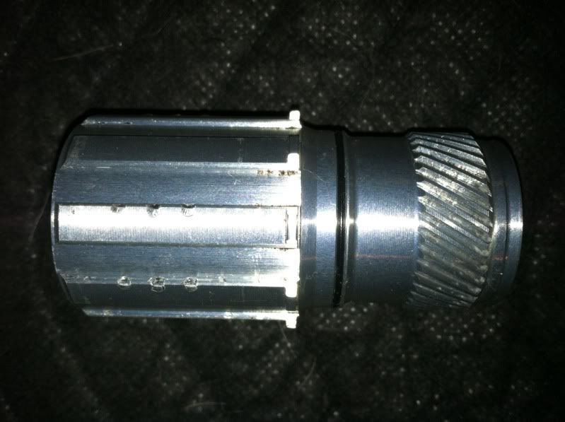

    Cycle Smith comes through again!
    Bye bye aluminum, make room for the stainless because I am a fat a$$.

    Yeah, large strong guys can't use aluminum freehub bodies if they climb steep technical stuff, unless they use XT/XTR type cassettes with aluminum carrier spiders, which spread the load out.

    Nah, nothing fat about you.
    Whoever looked at the cassette you wanted to use, and suggested the Kings as sold to you, obviously had their head up their a$$.

    Ok, maybe I just looked anorexic in my early years and now I actually have meat on my bones.
    This is why I need to stick with the MendonCycleSmith because Craig knows what he is talking about.
