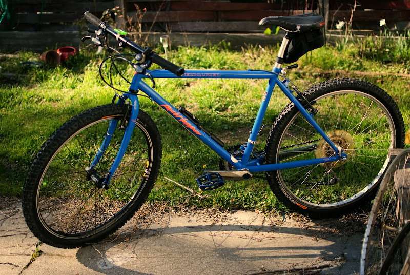

    Hi, I've been lurking for years but finally got around to creating an account.
    I'm in the process of getting my Specialized Rock Hopper ride-able again. I soon learned it's considered 'vintage'. The bike is 100% original. I think it's a 1990 or 1991 but I'm not 100% certain. I must have been just starting HS when I got it. I rebuilt one of the brifter as it has stopped ratcheting. Took apart almost all of the bike then cleaned everything I could and reassembled it. I've been out of the cycle world since '97 and a lot has changed since then. I'm hoping to get this bike up and running then I'll figure out what I want to do. Either keep riding it or get a new bike and keep both.
    It's hard to see in the photo but it has a good layer or dust and crud all over it. Most of the chrome was a bit rusty and there was dirt and grease all over. Luckily, the bike had been storied in a dry place for all that time. The corrosion happened when it was in Hawaii a few years. Anything and everything rusts there even when it's kept dry.
    I'm thinking that I'll try to keep the bike original and not change anything unless it's broken. I'm almost to the point there all I need are tires and tubes. I've been going back and forth on the many choices out there. It originally had Crossroads. I'm debating going with something mike a Maxxis Holy Roller or a Conti Race King or maybe a Gravity or Explorer. Or maybe Specialized Rhythms or Compound Pro's or even Crossroads agian (although the new ones are worlds different then my old ones)... I think I want to go with some wider tires though. The 1.95's were on the skinny side. Any help with tires would be appreciated.

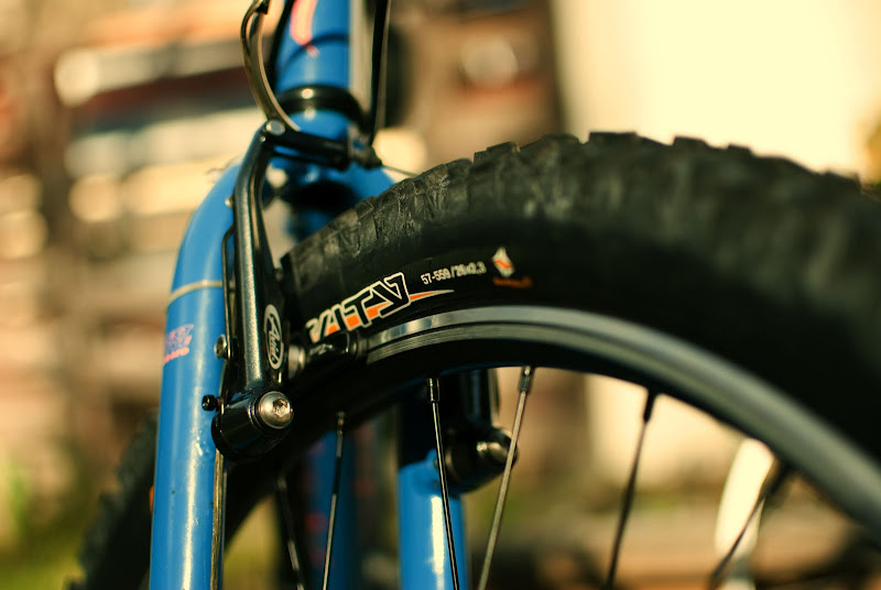

    Well, here's the bike with new tires and tubes. The wheels need to be trued up but otherwise everything else is adjusted.
    After 15 years off the bike, I really need to build my confidence back up. I remember the techniques but it's a bit unnerving riding something so small. Only got to about 30-35 MPH before I chickened out. I still need to see if I can find my old Avocet cyclometer.
    Next up, are bar ends and plugs! Don't need to take any core samples. If I take it any further, I might swap to V brakes and maybe go SS but that would be later.

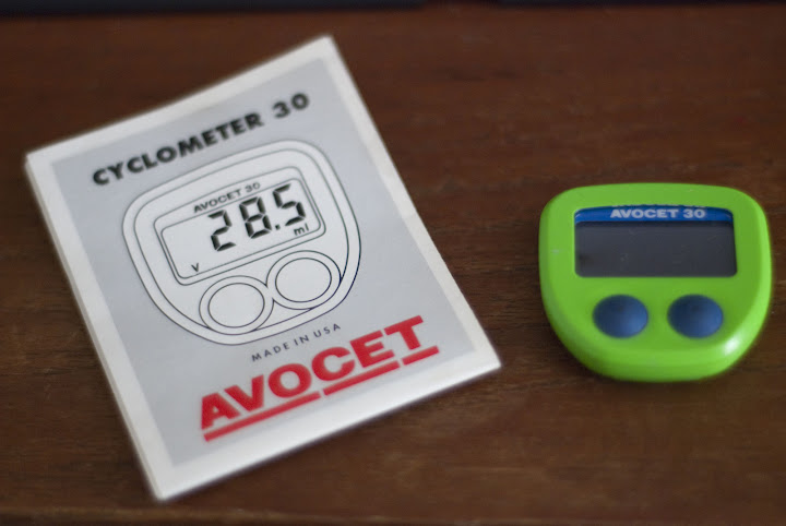

    Oh and I found my Cyclometer!

    Quote Originally Posted by notthatjeffy
    It still works?
    I had one back in the day, but it died of it's own accord.
    Actually, I haven't got a new battery for it BUT when I put it away, it did work.

    I was able to put some new parts on the bike. I rode it around with no brakes and I can't help buy notice how much more comfortable the seat is!(Speed V) The bike feels a bit lighter as well. With the new grips, the bars feel tiny and very light. The old ones were huge foam grips. These are nice and grippy. New cables should be here by Thursday.

    Fixing some loose ends still. I ended up hearing the knock again and pulled the cranks. Put them back and the knock turned into a creak. Tightened down the crank nut to 40ft-lbs and the creaking stopped. I'll have to get a proper puller as there isn't enough bite for my gear puller to work anymore. Unless I make some plates.
    So, I guess I'll be keeping my BioSpace gears and Exage 400 cranks. Hopefully, my spoke wrench will arrive tomorrow so I can try my hand at truing up the wheels. Then 'll be able to set the brakes up properly. I have a cassette took coming as well so I can remove the cassette and perhaps the spoke protector.
    So far I've probably managed to put 20 miles or so on it since fixing it up. I still have to get used to the thumbs as I'm not 100% on which way I need to adjust them all the time.
    I'm thinking that I'll eventually get some Mavic 719's with Shimano XT hubs later on. Then all that I'll need to do is ride it. Oh and get some shorts, gloves and new sunglasses.
    I'll probably take some more pics in a few days.

    79
    Nice '88. I always liked the two-tone paint scheme.
    I finally bought a chain whip and took the cassette off so all of you who didn't like the chain guard can celebrate. It's gone. Or more precisely has not been transferred to the new wheel. I also realized that the tubes have to have no air in them or else it makes getting the tire on a PITA. I had a little in the front I think which made it more difficult as the rim is much narrower and the bead probably wasn't able to drop down far enough.
    Reseated the front tire while I was at it since the tire had some wobble. Got the brakes set up pretty good too. They work a lot better on the Mavic's with the milled rim surface then the smooth Araya's I had. I still need to buy a head set wrench to tighten it down. It backs out if I do some aggressive braking. Have to readjust the rear derailleur a little too. Bought the 4mm spacer from Buildyourbike on ebay. Still not sure if I'll add bar ends of not. Other then that though, I think it's done and just needs some dry weather to start riding again.
    Here's a recap of what's been done;
    • Shimano Deore XT Thumb Shifter
    • Shimano Deore XT Front Derailleur
    • Shimano Deore LX FC-M582 Crankset
    • Shimano XTR Front and Rear Brake Cables
    • Shimano Deore Hubs
    • Mavic 117 Wheels
    • Continental 2.3 Gravity Tyres
    • Avid Speed Dial 7 Levers
    • Avid Single Digit 7 Brakes
    • WTB Speed V Comp Saddle
    • SCRAM Locking Grips
    • Wellgo MG-1 Pedals
    Tool's purchased:
    • Park Tool SW-42 Spoke Wrench
    • Park Tool FR-5G Cassette Lock ring tool with guide pin
    • Park Tool BBT-9 Bottom Bracket Wrench
    • Park Tool Compact Crank Puller
    • Park Tool HCW-5 Lock Ring Spanner
    • Park Tool SR-1 Sprocket Remover
    Thank you to all those who have helped answer my noob questions. It's been a fun project and I think it was well worth the effort. Not to mention it was cheap. If I had to do it over again, I think I would. I haven't really thought about getting another bike. I don't think I have to anymore.
